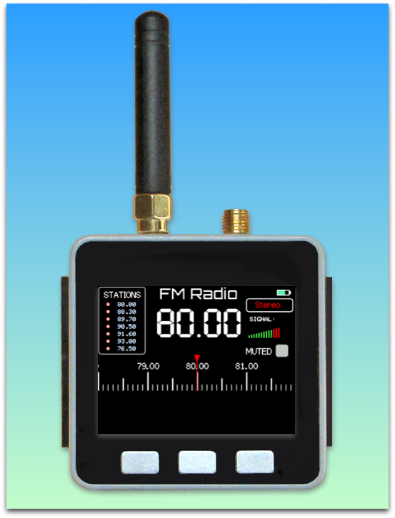

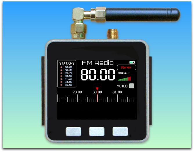

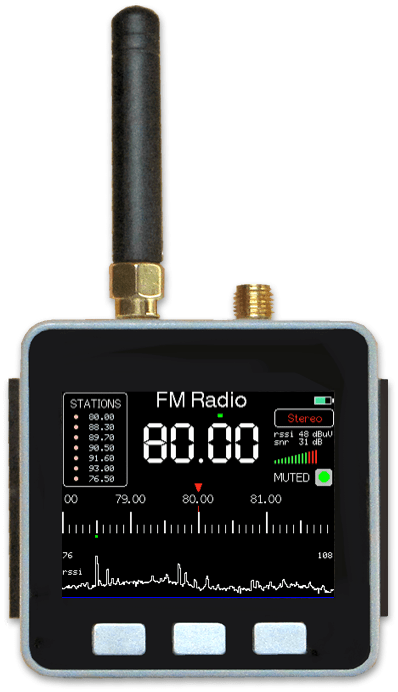

M5Stackと SI4732 DSP で FM Radio を製作しました。
アリエクで流行っている ATS mini (Encoder操作) 似の受信機です。
操作はA,B,Cボタンで 行います。
BLOG : M5Stack FM Radio
https://macsbug.wordpress.com/2025/08/14/m5stack-fm-radio/

I created an FM radio using M5Stack and an SI4732 DSP.
The receiver is similar to the ATS mini (encoder operated), which is popular on AliExpress.
It is operated using the A, B, and C buttons.

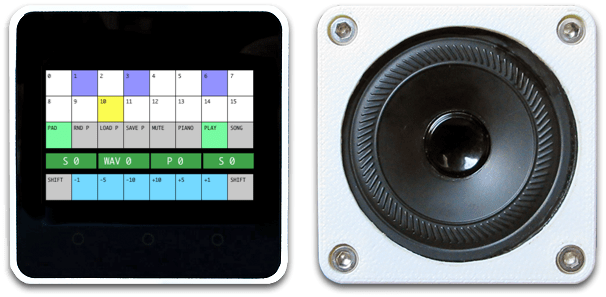

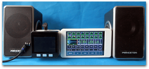

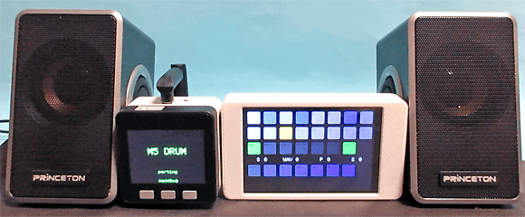

BLOG:https://macsbug.wordpress.com/2025/01/14/drum-with-m5core2/
M5Core2 320×240 LCDで KeyPadを操作しDACでDRUMを奏でます。
BLOG:https://macsbug.wordpress.com/2025/01/13/drum-with-m5stack/
M5Stackと3.5″ 480×320 LCDで KeyPadを操作しDACでDRUMを奏でます。
M5Core2 320x240 LCD
Operate the keypad and play drums through the DAC.
Using the M5Stack and a 3.5" 480x320 LCD, I control the keypad and play drums through a DAC.
