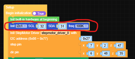

@kuriko said in TAB5 I2C issues using UIflow2:
@BR123456
The default internal I2C scanner of Tab5 in UiFlow2 has bug, we are now fixing it!
I've just found a hack for this bug.
One has to define the I2C port pins before initializing the stepmotor module, as shown in the image.
The module works fine now.

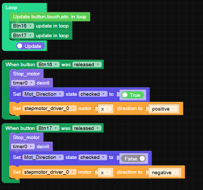

See attached photos for the code using pin buttons:
Define pin buttons on setup:
Call for update in main loop and define operations when called:
In my case I use two optocouplers, one for each end of the travel.
Their callbacks stop the motor and reverse the motor direction.
