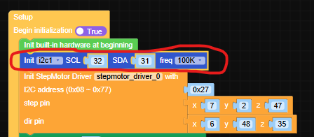

              I've just found a hack for this bug.
              One has to define the I2C port pins before initializing the stepmotor module, as shown in the image.
              The module works fine now.
              F 1 Reply Last reply Reply Quote 1

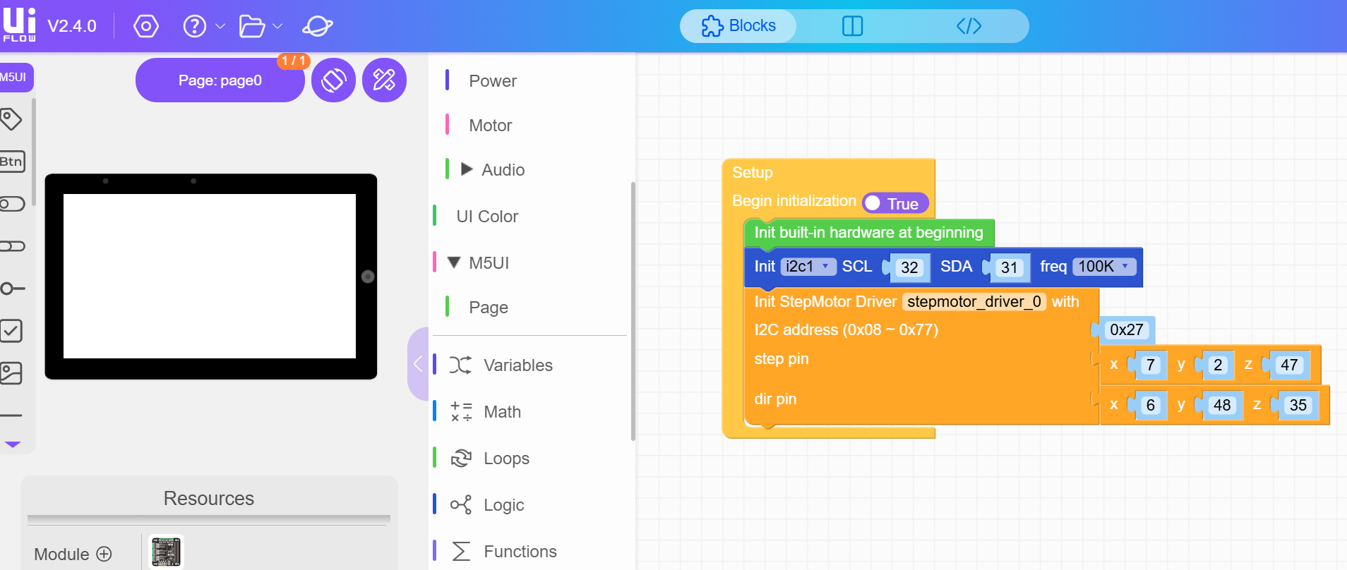

                @BR123456, @kuriko Hi BR123456, kuriko,
                we also tried your fix - unfortunately it did yet not work for my project
                We have the following situation:
                • M5Stack Tab 5 with UIflow 2.4.0
                • We also have connected a Module13.2 Stepmotor Driver v1.1 on the Tab5
                • The UIflow web version is 2.4.0 https://uiflow2.m5stack.com
                  We could not sort out how to connect to UIflow Web 2.3.8.
                Our UIFlow test code:
                We also installed UIflow version 3.8.0 on the tab 5 but this did solve the problem.
                Our error message looks like this:

                E (14740) i2c.master: this port has not been initialized, please initialize it first
                Could you give us a hint how we can solve our problem and let turn the motors.
