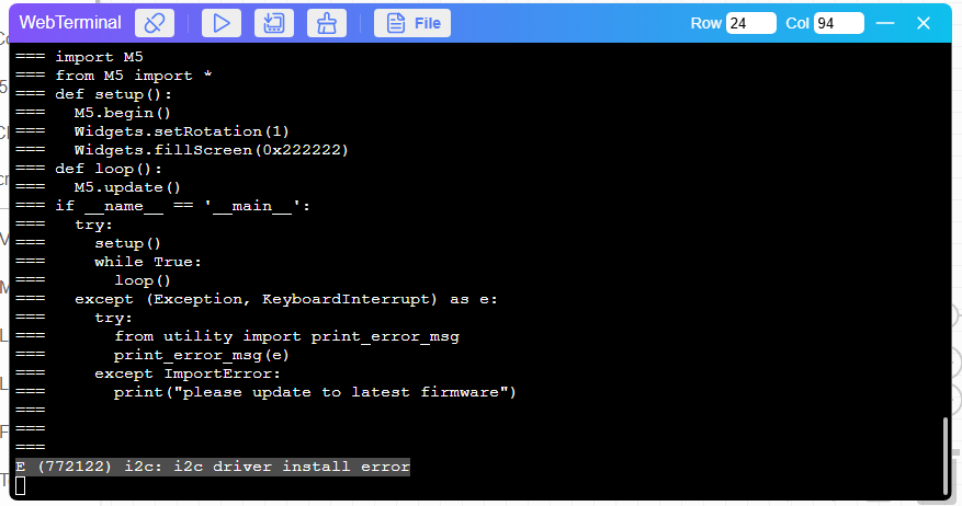

    i2c driver install error

      known issue, seems doesn't affect anything, will fix it soon

      • K Offline
        kmk68 @kuriko
        @kuriko Yes, it affects. The program does not start on my M5 Core after this message....

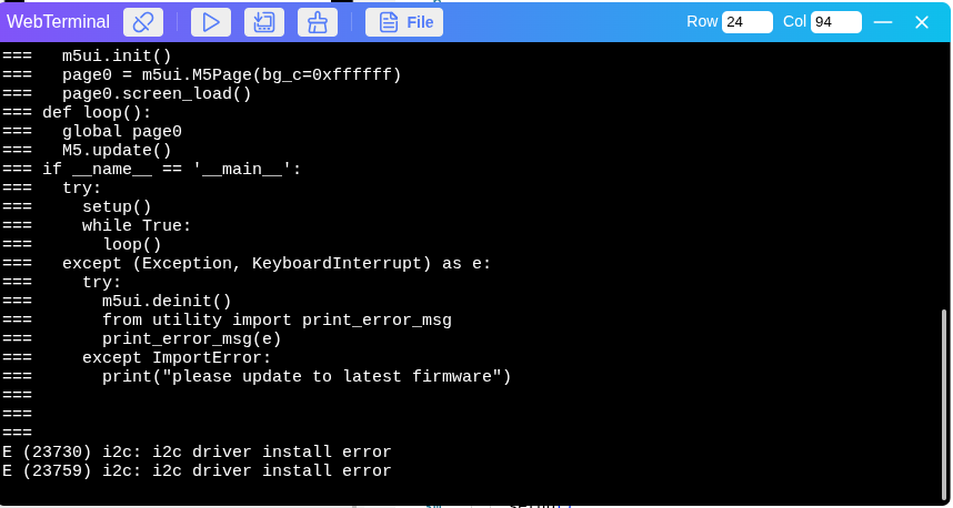

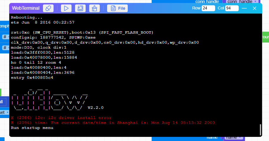

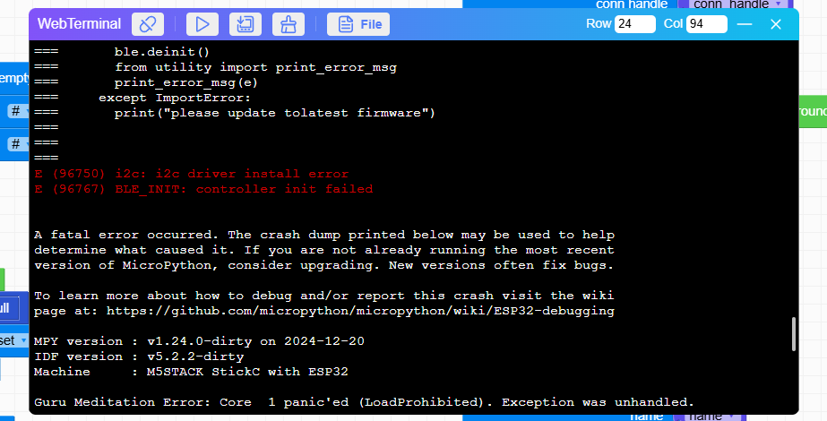

              • C Offline
                Calvorotas
                Hi,
                I have problems with UiFlow 2.2.0.
                I could use BLE with UiFlow 2.1.8, but the same program doesn't run in 2.2.0.
                The progam can't start. The device return at Uiflow main menu.
                I have update UiFlow in the devices (Core M5stack and StickC, but I have the same problem.
                Thanks.

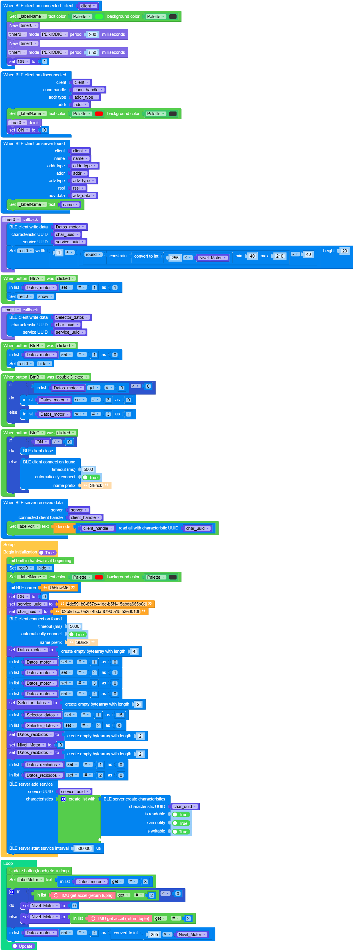

                  Hi,
                  Another program without BLE.
                  I am not using MQTT in this program.
                  Thanks.
                  • kurikoK Offline
                    kuriko @Calvorotas
                    @Calvorotas
                    can you provide the .m5f2 file? imma do a test to check out if it's a firmware problem

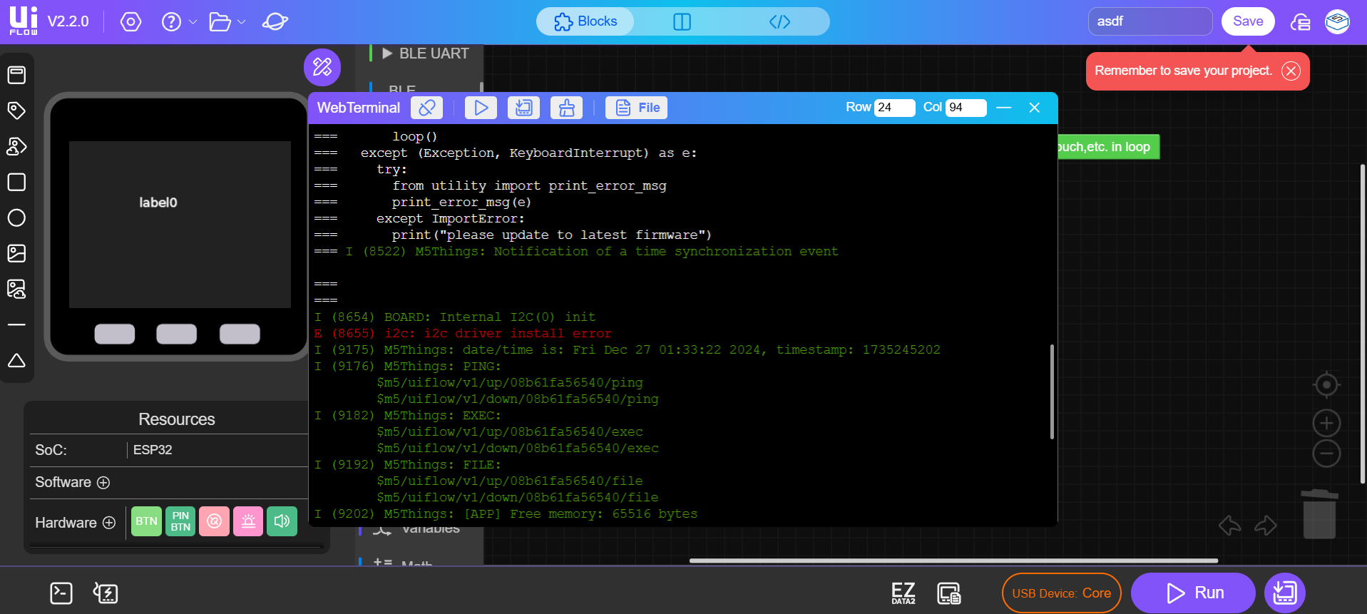

                    • _ Offline
                      _e3e6
                      Same issue here with Atom Echo and the Web UIFlow 2.0
                      https://gist.github.com/e3e6/f8558f8487dad2fe8909c8dc17b80888

                            @kuriko Several months have passed since this post, but the error persists. Do you really plan to fix it?!
                            M 1 Reply Last reply Reply Quote 2
                            • M Offline
                              mearsuit @Hulkco
                              yep...Same problem, i cant upload any python code without getting this error. Its a shame because its a really neat dev board and i really wish the people at m5stack would fix this problem. They would begin to see more projects being posted on the m5burner and it would only help their sales. Screenshot_2025-09-25_18-21-33.png

                                @mearsuit i see this error from some time but projects are working ok
                                M5StickC, M5StickCPlus, M5StickCplus2,M5GO, M5Core, M5Tough, M5Core2, M5 Demo Board, M5Dial, M5Paper, M5Atom, M5Cardputer, M5StampS3, CoreMP135, StamPLC, AirQ, M5Tab, M5CardputerAdv, M5StackChan
