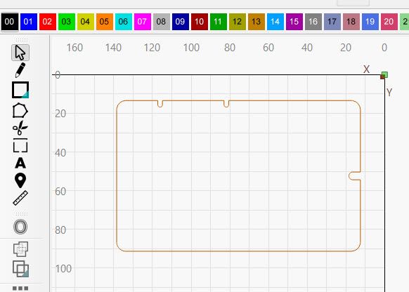

Not exactly sure where to post this BUT over the weekend I created a simple screen protector sheet design for the M5stack Tab5.
I laser cut the design out onto a sheet of screen protector.
I have exported the design out into multiple file types ( .svg, .dxf, .ai, .lbrn2) so hopefully one of four file types will work for people who may be interested in making a screen protector for their Tab5.
Just be sure to be careful and take the necessary precautions when dealing with the fumes when cutting material with a Laser Cutter...

Also if you are looking for a screen protector for your Tab5, I created a simple design over the weekend and laser cut it out on a sheet of screen protector.
I have exported the design out into multiple file types so hopefully one of four files will work for people who may be interested in a screen protector for their Tab5.
