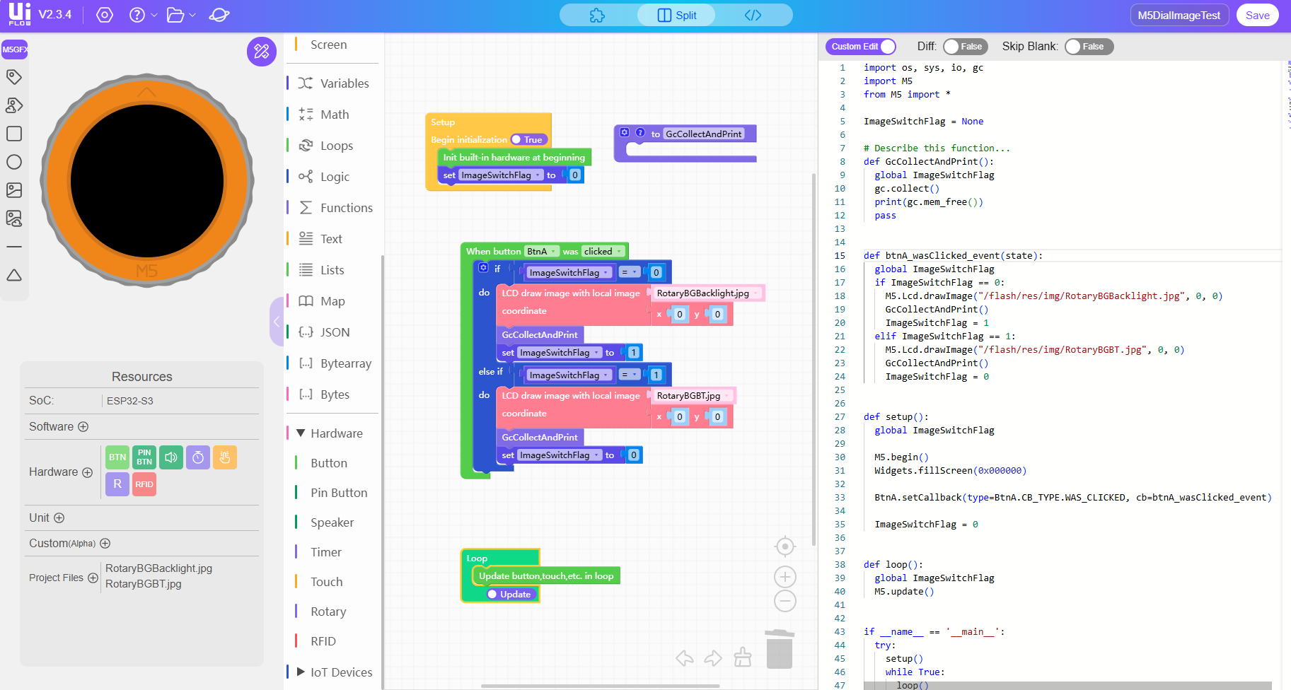

                                      • Z
                                        zhumingqi
                                        Today, I updated the UIFlow to V2.3.4, and burned V2.3.4 firmware as well. Then I tested that image component again with M5GFX in UIFlow 2.3.4. But the issue still exists. After I switch two JPG pics with one image component for sometime, the memory will reduced continiously. Finally, the system will break out. And I try to use gc.collect() after every drawImage(), but it's not useful.
                                        Here is my design and python code:
                                        import os, sys, io, gc
                                        import M5
                                        from M5 import *
                                        ImageSwitchFlag = None
                                        def GcCollectAndPrint():
                                        global ImageSwitchFlag
                                        gc.collect()
                                        print(gc.mem_free())
                                        pass
                                        def btnA_wasClicked_event(state):
                                        if ImageSwitchFlag == 0:
                                        M5.Lcd.drawImage("/flash/res/img/RotaryBGBacklight.jpg", 0, 0)
                                        GcCollectAndPrint()
                                        ImageSwitchFlag = 1
                                        elif ImageSwitchFlag == 1:
                                        M5.Lcd.drawImage("/flash/res/img/RotaryBGBT.jpg", 0, 0)
                                        GcCollectAndPrint()
                                        ImageSwitchFlag = 0
                                        def setup():
                                        M5.begin()
                                        Widgets.fillScreen(0x000000)
                                        BtnA.setCallback(type=BtnA.CB_TYPE.WAS_CLICKED, cb=btnA_wasClicked_event)
                                        ImageSwitchFlag = 0
                                        def loop():
                                        M5.update()
                                        if name == 'main':
                                        try:
                                        setup()
                                        while True:
                                        loop()
                                        except (Exception, KeyboardInterrupt) as e:
                                        try:
                                        from utility import print_error_msg
                                        print_error_msg(e)
                                        except ImportError:
                                        print("please update to latest firmware")******
