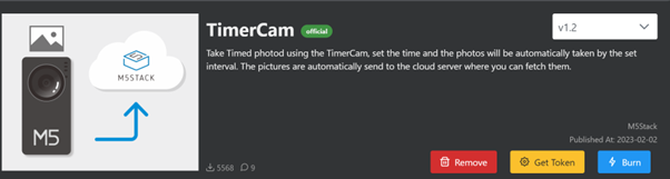

      Hi,
      I wish to program TimerCamera-X using MicroPython but when I flash them using this:
      I get this shell message in Thonny even before I start to program:

        This is not a Micropython firmware. This firmware was used to post images through HTTPS to controllers which was programmed in UIFlow.
