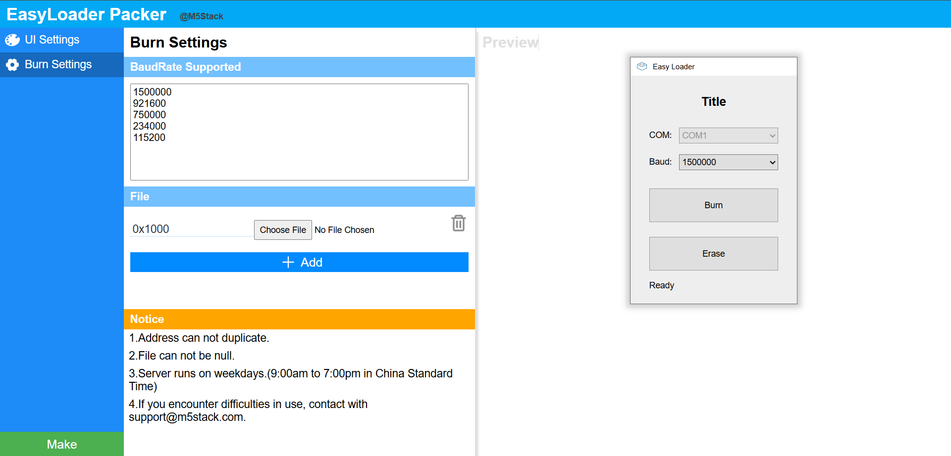

        @Marcy72317 have you tried easyloader from m5stickC+2 docs page?
        M5StickC, M5StickCPlus, M5StickCplus2,M5GO, M5Core, M5Tough, M5Core2, M5 Demo Board, M5Dial, M5Paper, M5Atom, M5Cardputer, M5StampS3, CoreMP135, StamPLC, AirQ, M5Tab, M5CardputerAdv, M5StackChan
        M 1 Reply Last reply Reply Quote 0
        • M Offline
          Marcy72317 @robski
          @robski wat file do i need to use??
          robskiR 1 Reply Last reply Reply Quote 0

            @Marcy72317 easyloader demo from m5 stack docs page for m5stickC +2

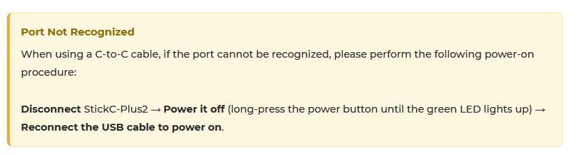

              @robski why can't i select the COM5, my device is connected to that port...ab65c756-460b-420e-a1ce-e6d0aa432ffc-image.png

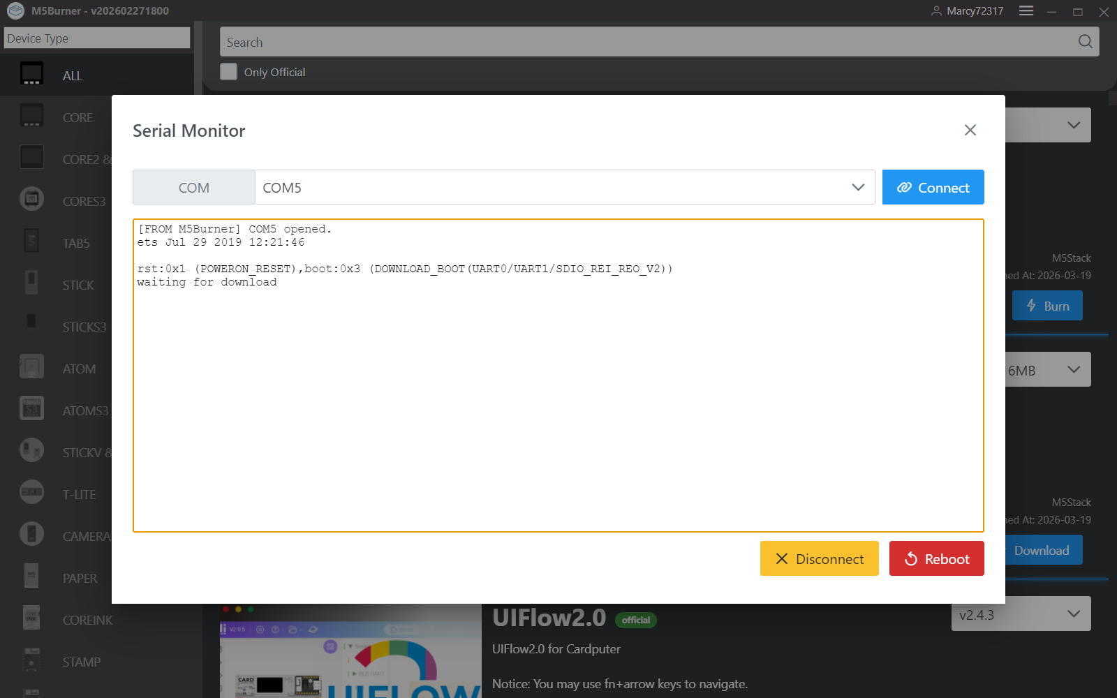

                @Marcy72317 is there any messages on com port monitor in M5Burner you see on this device?
                • M Offline
                  Marcy72317 @robski
                  @robski i don't see nothing

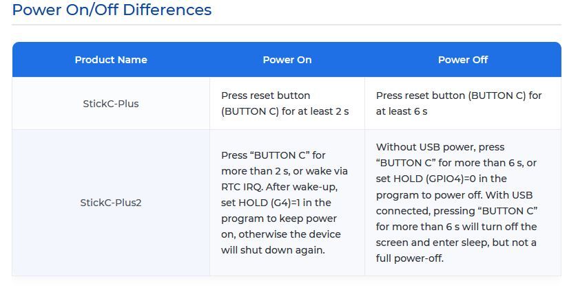

                    @Marcy72317 could it be in sleep mode?
                    can you properly switch it off and on then try easyloader?
                    M 2 Replies Last reply Reply Quote 0

                      @robski tried holding for more that 6 sec, still nothing, i can't really tell if it is in sleep or on or off since the screen desn't lights up.
