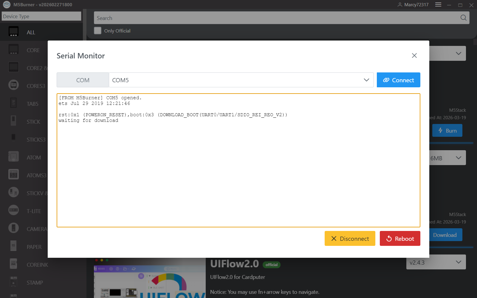

@robski tried holding for more that 6 sec, still nothing, i can't really tell if it is in sleep or on or off since the screen desn't lights up.
RE: M5StickC Plus2 Not workingposted in SOFTWARE
@robski why can't i select the COM5, my device is connected to that port...
Hi, i bought my StickC plus 2 in 2025, it was working for a couple of days before stopping. When i hold the power button only the green light lights up but the screen remains black. tried erasing and flashing new and official firmwares but still the process seems to be succesfull:
