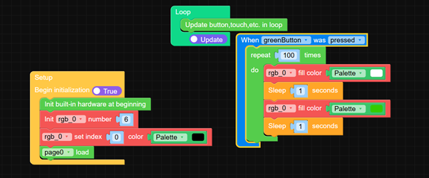

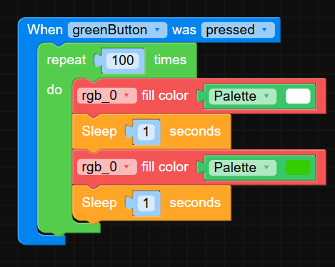

      I'm using UIFlow v2.4.2 and want to run the flashlight continuously without the current 100 cycle limit. Is there a way to trigger an infinite loop that I can break manually? Any ideas, examples or suggestions would be great!

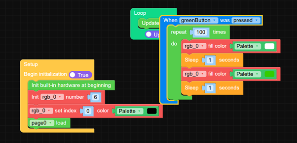

          @robski can not drag it into the loop, it is outside

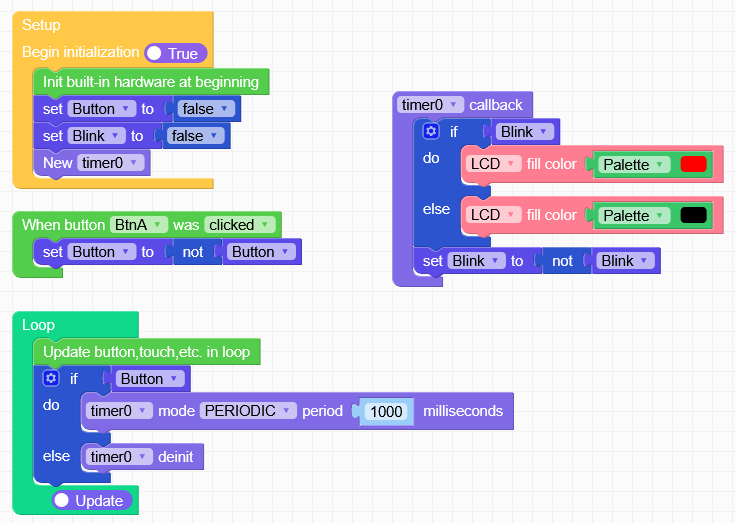

            Just as an idea, code not tested:
            Avoid to loop somewhere except the main loop!
            Setup:
            • Create a variable called "Button" to enable/disable the flash function
            • Create a variable called "Blink" for the current state of the light
            • Start a timer
            Button clicked:
            • Invert the state of "Button"
            Main Loop:
            • If Button is TRUE, start the timer
            • else (If it is FALSE) stop the timer
            • your other code doing somewhat
            Timer0:
            • Blink the LCD (or whatever you want) using the "Blink" variable
            J 1 Reply Last reply Reply Quote 0

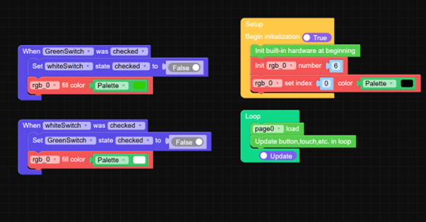

              At the end I used switches and it works.
