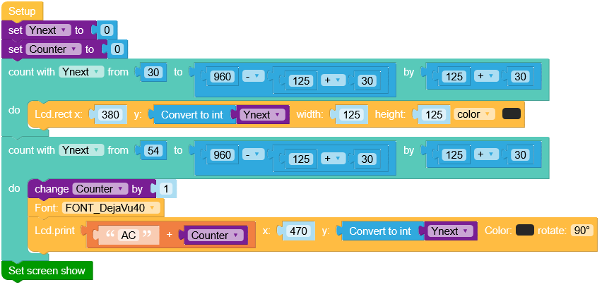

      I created a simple loop to draw several squares (touch buttons) with text. However, the last square (the second loop) isn't filled with text, and the loop only loops 5 times.
      What am I missing?
      Note:
      UIFlow 1.0
      I am using the screen horizontally.
      960 pixels total (Y)
      6 buttons, 125 pixels
      30 pixels spacing
      from m5stack import *
      from m5ui import *
      from uiflow import *
      setScreenColor(15)
      Ynext = None
      Counter = None
      from numbers import Number
      def upRange(start, stop, step):
        while start <= stop:
          yield start
          start += abs(step)
      def downRange(start, stop, step):
        while start >= stop:
          yield start
          start -= abs(step)
      Ynext = 0
      Counter = 0
      Ynext_end = float(960 - (125 + 30))
      Ynext_inc = float(125 + 30)
      for Ynext in (30 <= Ynext_end) and upRange(30, Ynext_end, Ynext_inc) or downRange(30, Ynext_end, Ynext_inc):
        lcd.rect(380, int(Ynext), 125, 125, color=0)
      Ynext_end2 = float(960 - (125 + 30))
      Ynext_inc2 = float(125 + 30)
      for Ynext in (54 <= Ynext_end2) and upRange(54, Ynext_end2, Ynext_inc2) or downRange(54, Ynext_end2, Ynext_inc2):
        Counter = (Counter if isinstance(Counter, Number) else 0) + 1
        lcd.font(lcd.FONT_DejaVu40)
        lcd.print(((str('AC') + str(Counter))), 470, int(Ynext), 0, rotate=90)

        @RIDDSprojects I think you need to change your second loop to loop to a value of 960 - (125 + 54)) not 30. I think, without trying it myself, the second loop ends too soon because you are starting at offset 54, not at 30.
        • robskiR
          robski @RIDDSprojects
          @RIDDSprojects your Ynext end2 (805) must be diff to Ynext end (805) ... add 24?
          M5StickC, M5StickCPlus, M5StickCplus2,M5GO, M5Core, M5Tough, M5Core2, M5 Demo Board, M5Dial, M5Paper, M5Atom, M5Cardputer, M5StampS3, CoreMP135, StamPLC, AirQ, M5Tab, M5CardputerAdv
          V 1 Reply Last reply Reply Quote 0
          • V
            veryalien @robski
            @robski Adding 24 is exactly the same as my solution, 30+24=54 and changing the "to" in the loop block will change the python end2 value. It should then work as expected.
