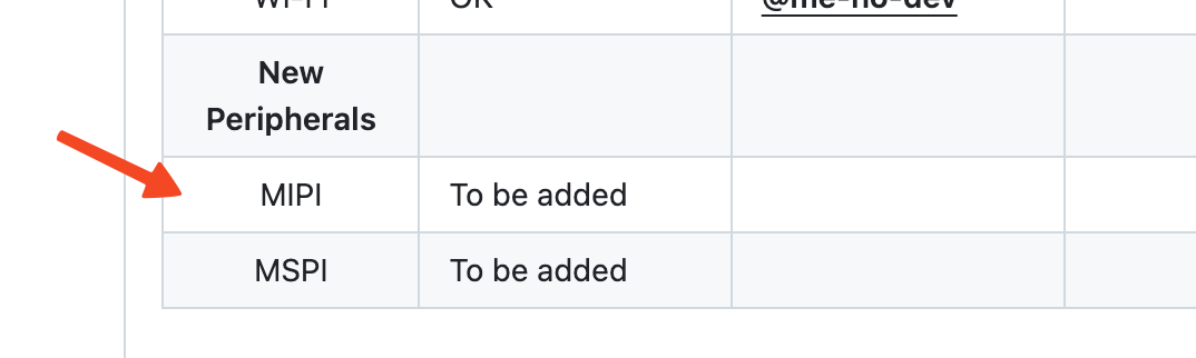

            The Tab5 camera adaptation is currently pending until Espressif adds MIPI driver support for the ESP32-P4.
            G 1 Reply Last reply Reply Quote 0
            • G
              gektron @kuriko
              @kuriko Thank you for the update. I look forward to the bug fix and the forth coming camera implementation (hopefully Espressif will add MIPI support soon).

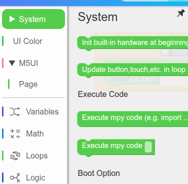

                I agree, the Execute mpy code block is a bit hidden in UIFlow2. But as I said before you can find it in System:
                Thanks
                Felix
                Code examples
                • G
                  gektron @felmue
                  @felmue Doh! I was looking under system at the menu options. I didn't think to click on system for the block menu. Thanks for the guidance.
