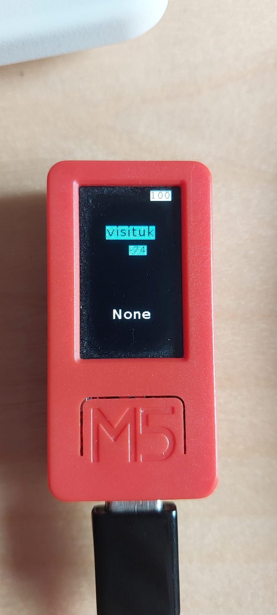

      Flashing fails with different symptoms:
      Maybe a year ago or more i had tried, and it always finisthed after an abnormally fast flash-progress (2-3sec.) with a success message, but then never showed anything on display, looked like dead.
      I could always return to UIFlow 1 Versions.
      Now i tried again, and after a few fails it worked one time, i saw the new UI. But i could not connect.
      So i flashed again with an older Version, 2.3.0 i think.
      But now the screen was black again. Pushing buttons plays the different pitch beeps, and the screen shows some of the elements:
      2cdbd858-a4fa-4647-9212-3849aadf62eb-WhatsApp Bild 2025-07-15 um 17.33.18_5c1d9b85.jpg
      I have two of the sticks, same issue with both...
      Again, i can return to UIFlow1, but no luck with UIFlow2.
      I tried multiple erases before flashing too, no change.
      Is this a known issue? Any ideas to fix it?

          sirtet @robski
          Thanks @robski. I tried the latest 2.3.1 , the oldest 2.0.3 and more.
          I just tried again,
          Now it works with 2.0.3
          and up to 2.2.6
          2.2.7 and newer ones i get this weird black screen with some elements showing up when pressing buttons, as in the screenshot above.
          in some cases, i could not burn a lower version until i used the erase option before burning.
          EDIT:
          now i realized with 2.2.7 and up to 2.3.1 although the screen is black on bootup, it connects to the cloud and i can send programs to it.
          So, form 2.2.7 on just the UI broken.
