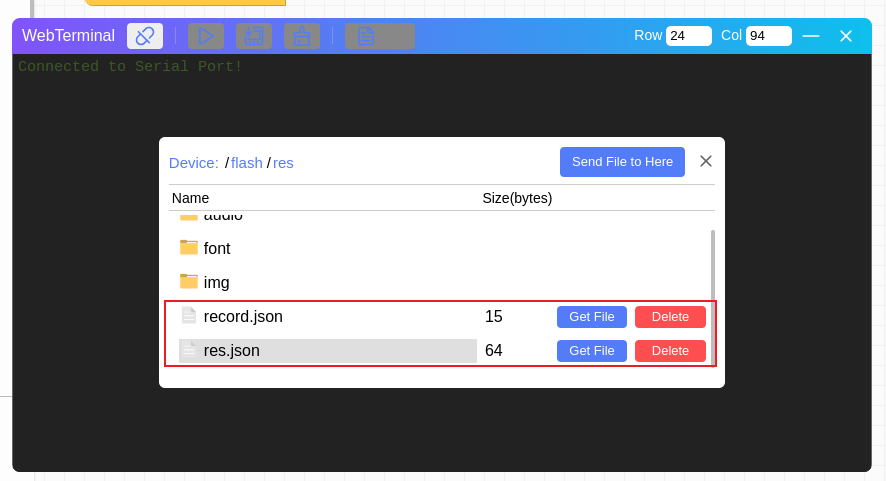

        The file may be deleted on the UiFlow IDE, but the device did not receive the synchronization information or lost the synchronization information, resulting in the device being unable to download the file.
        You can try the following 2 methods:
        1. Reburn the UiFlow2 firmware.
        2. Delete the 2 following files of device:

          I did this step by step.
          Deleted
          • record.json
          • res.json
          After pushing the code, the problem remains the same., error 403
