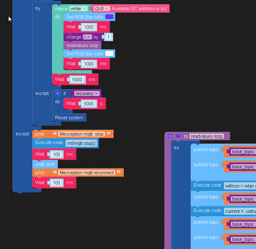

      Hey guys, i have used "try" around my i2c loop and mqtt to get the error and try to recover from it. how ever struggeling to fix it( i heard from an alternative mqtt library but i wanted to know if you guys have another idea)

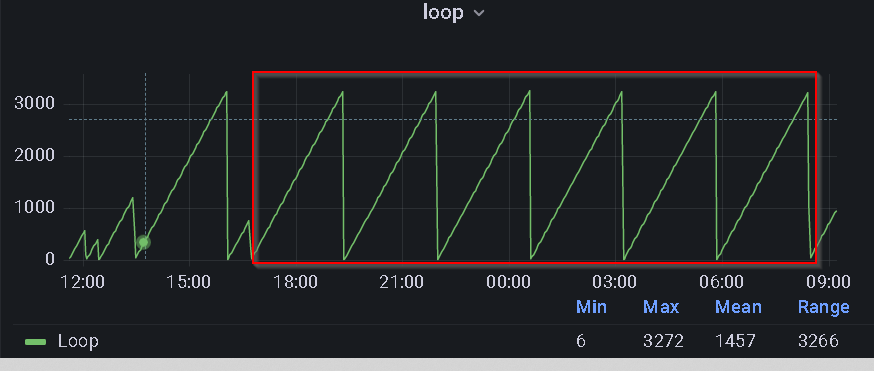

      Here you see my grafana graph. Loop gets increased after every "readvalues loop function" (mqtt )
      After these about 3000 loops it resets.
      Here is the flow:
      And this( bottom of the read values function) :

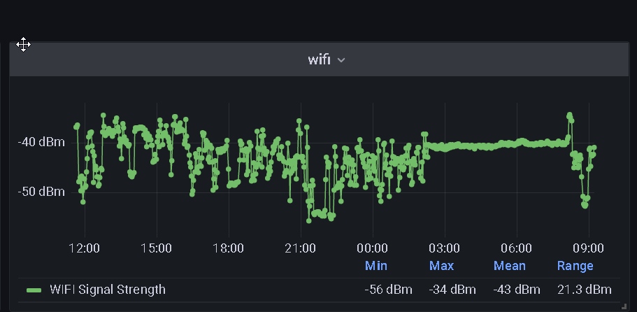

      i get -104 mqtt exception and -110. i dont get to except it and try to stop the mqtt, wait a sec and start again. The wifi signal is good and its 1 m to the AP on this Atom ( not like in the other thread)
