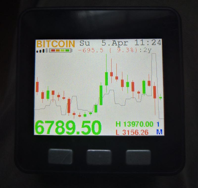

              What’s the while line on the chart?
              frittnaF 1 Reply Last reply Reply Quote 0
              • frittnaF
                frittna @yashax
                @yashax
                the white line is the relative trading volume from the last 24 shown candles
                Y 1 Reply Last reply Reply Quote 0
