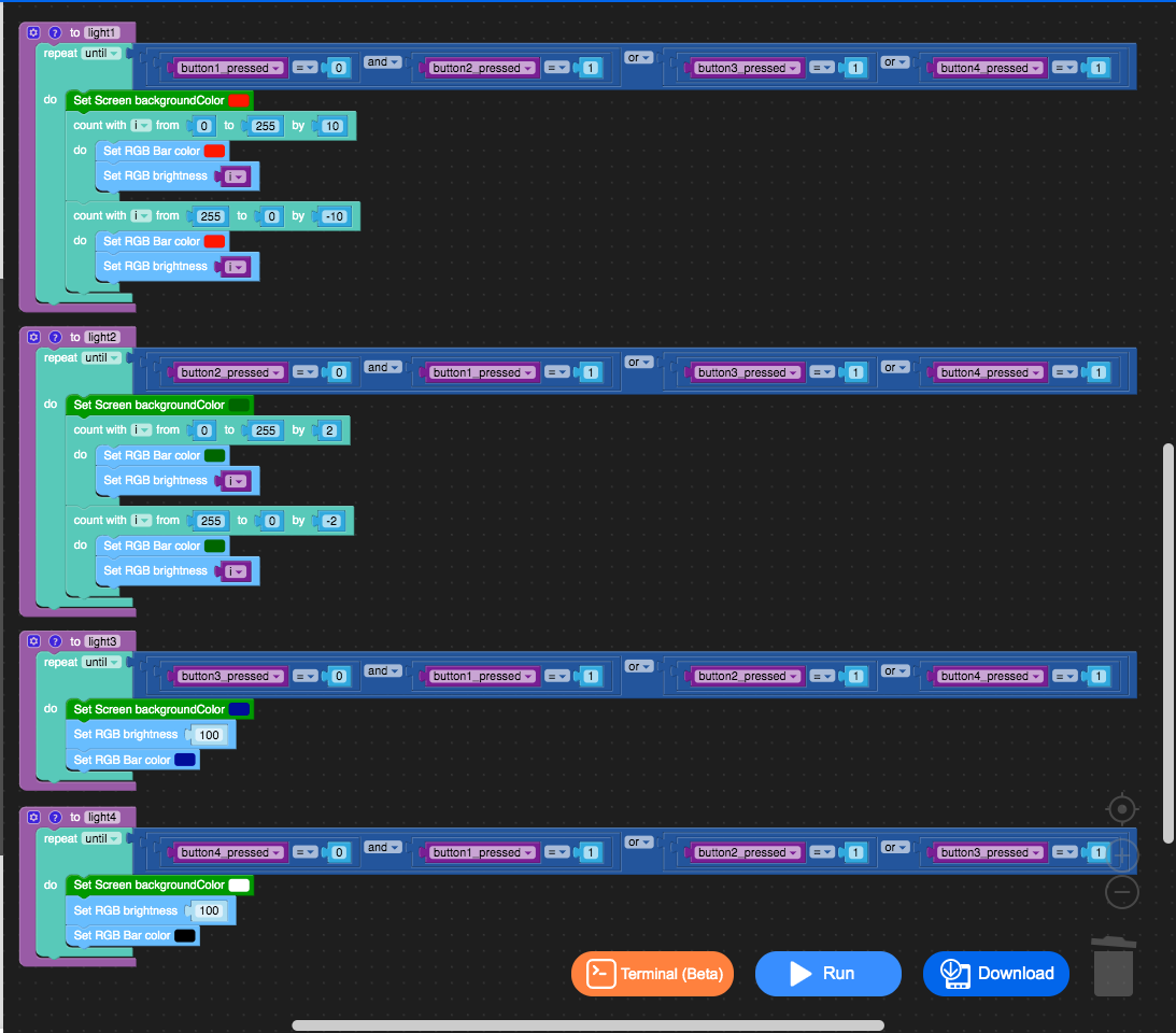

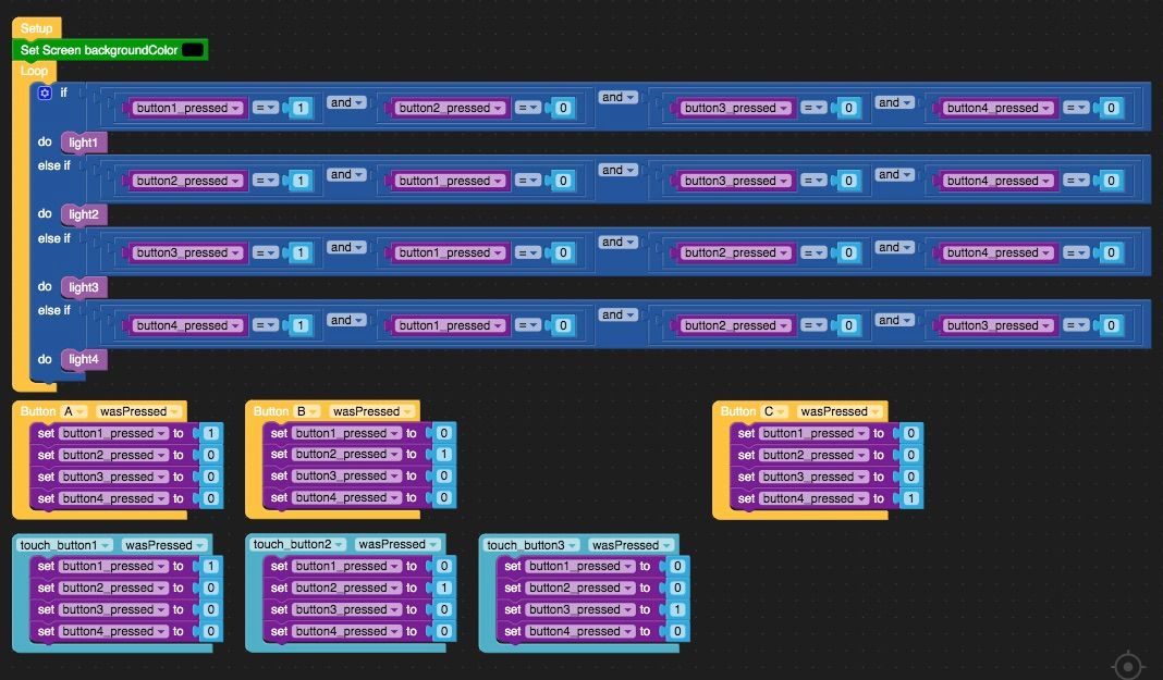

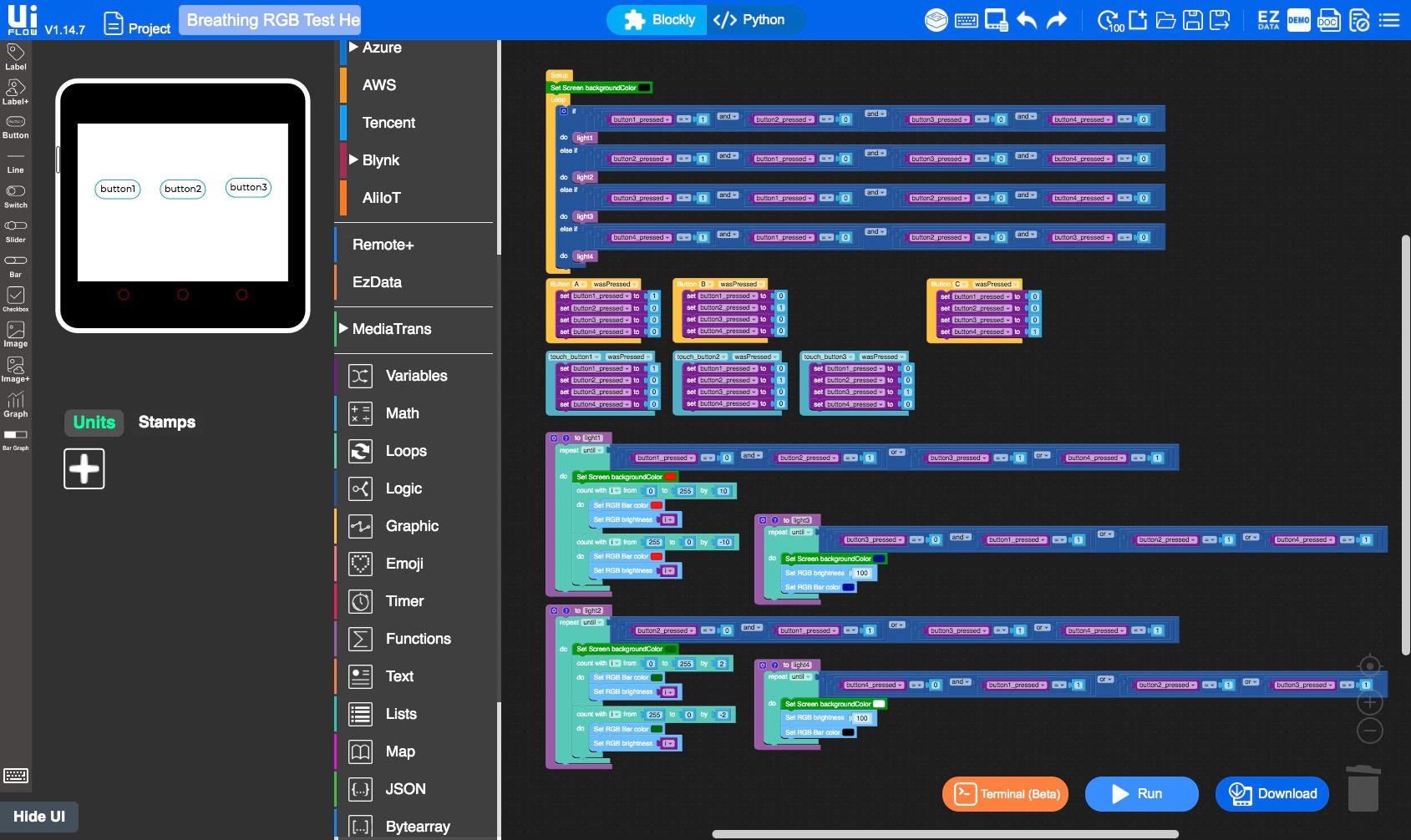

Thank you so much for your help Kurikio. And for your crazy fast response. This is exactly what I needed to get myself back on the right path. I through together a quick test this morning and everything is now running smoothly and I'm able to change between different lighting setting with out the program crashing or getting stuck in a endless loop.
Here's what I ended up putting together. Three buttons on the display that could change between three preset colors and a effect pattern, the A and B buttons mirrored the first 2 button and the C button turned off the lights.
Thank again so much for your help. Here are some photo of my end result:
