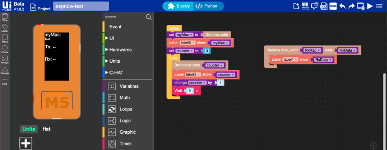

I use this code in stickc as esp receiver for debug. And on other atom lite i use only broadcast datablock with convert to str block with my message. And its works.
A
Send the message as a string. If you want to send a list, cast it to a string, then use eval() in the receiver.
