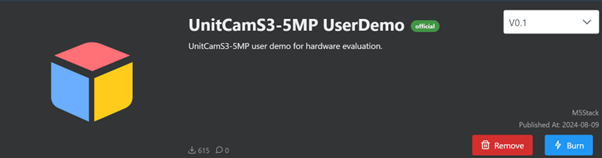

      I wish to program Unit CamS3 using MicroPython but when I flash them using this:
      I ge this shell message in Thonny even before I start to program:
      PROBLEM IN THONNY'S BACK-END: Internal error (serial.serialutil.SerialTimeoutException: Write timeout).
      See Thonny's backend.log for more info.
      You may need to press "Stop/Restart" or hard-reset your MicroPython device and try again.
      Process ended with exit code 0.

        kuriko @l.roca
        @l-roca
        This is not a Micropython firmware. You might need to configure and flash the firmware yourself: https://micropython.org/download/
        L 1 Reply Last reply Reply Quote 1
