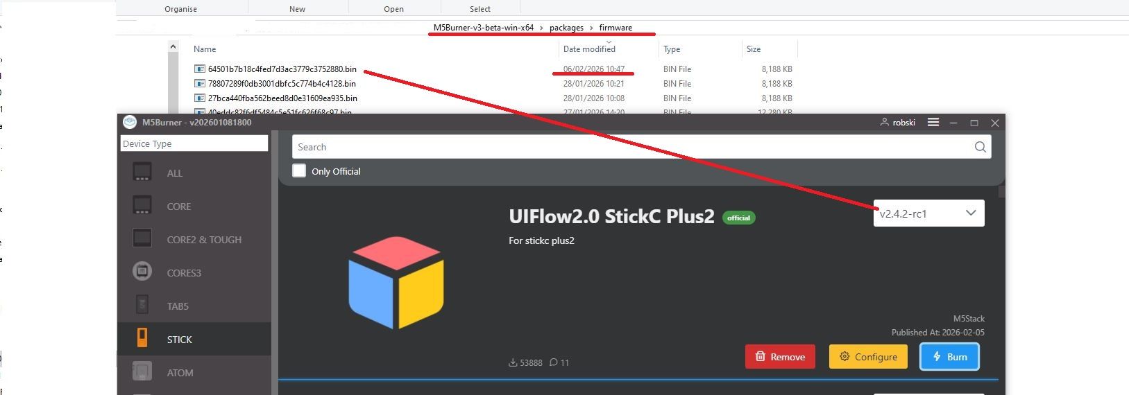

                @andyzot so you can't find location where downloaded firmwares are stored on MAC?
                see Win10 example
