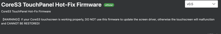

      I did the “hotfix” firmware and now my capacitive touch issue not working properly. It seems like it isn’t calibrated because it is reading the touches in reverse and to the left edge of the screen.
      I have tried everything I can to erase the NVS and get the original firmware running. Does anyone know how to get it back to the original state? Flashing the demo firmware did not work. I wonder if it needs to calibrate somehow since I updated the firmware with the hotfix program. I don’t know why I ran it because it was working fine before I did that.

        Did you "erase" the firmware first? Updating the firmware does NOT erase the configuration of the device based on my experience with the M5Dials.
        Hope this is the problem-Brian

            [link text](https://ibb.co/CKrX3GhS!Screenshot 2026-01-20 at 11.11.04 AM.png )
