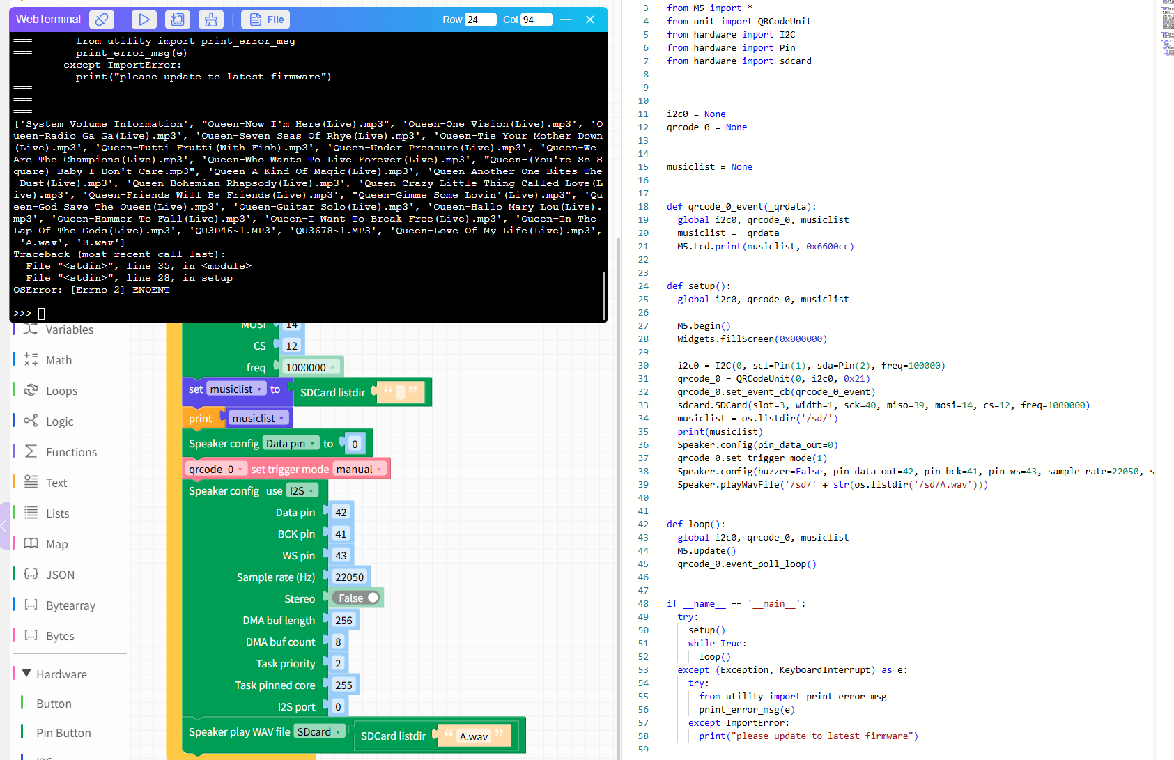

      I cannot find any demo on the web and in official doc, the demo is not as what I can find in UIflow, any one know how to use it ?
      Z 1 Reply Last reply Reply Quote 0
      • Z
        zhouyousong @zhouyousong

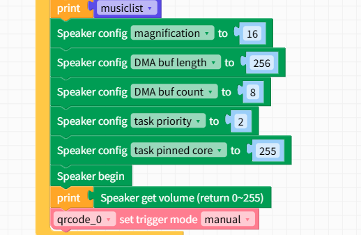

        currently I can play wav file, but I found it cannot run in background, if I started one wav, loop will be blocked till this wav finished. 3e965176-d6a9-41d1-9178-1348c0263903-image.png
        I have tried to change the priority. any one know how to fix this ?

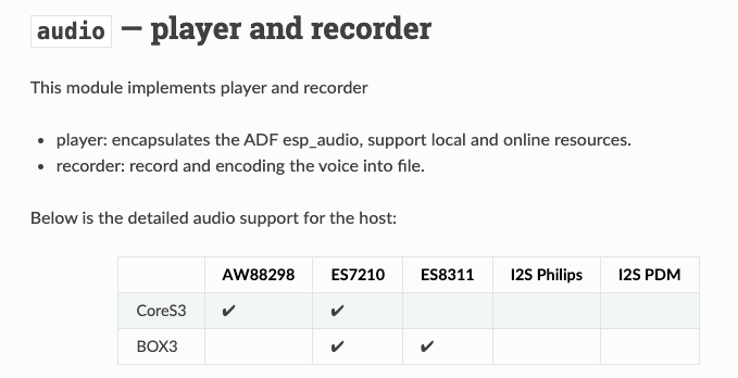

          Currently, only CoreS3 and Box support using the ESP-ADF Audio Player library, and only these two devices support background audio playback.
          https://uiflow-micropython.readthedocs.io/en/latest/system/audio.html
