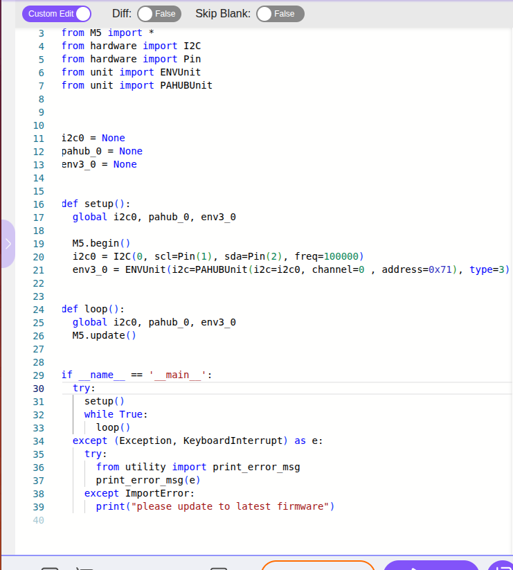

          @felmue I followed the instructions, and am getting this result"
          File "<stdin>", line 21, in <module>
          File "<stdin>", line 15, in setup
          File "unit/env.py", line 41, in init
          File "driver/qmp6988.py", line 99, in init
          File "unit/pahub.py", line 100, in readfrom_mem
          File "unit/pahub.py", line 37, in select_channel
          OSError: [Errno 19] ENODEV
          Here is the relevant code
          • felmueF
            felmue @Boomvalt
            Hello @Boomvalt
            I do not have an M5AtomS3R, but with my M5AtomS3 it works for me. See M5AtomS3_PaHUB_EnvIII_EnviV_UIFlow2.2.8 example in UIFlow2 Project Zone.
            Make sure you power-cycle everything after changing the I2C address of PaHub. And maybe try another channel for the EnvIII unit?
            Thanks
            Felix
            Code examples
            B 1 Reply Last reply Reply Quote 1
            • B
              Boomvalt @felmue
              @felmue Finally got it working correctly. In addition to your code, I initialised the Pahub, and then changed the dip switch to 0x71. Additional units work fine when assigned to 0x71.
