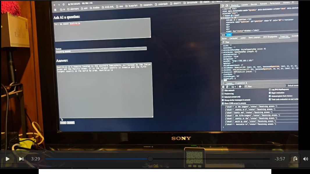

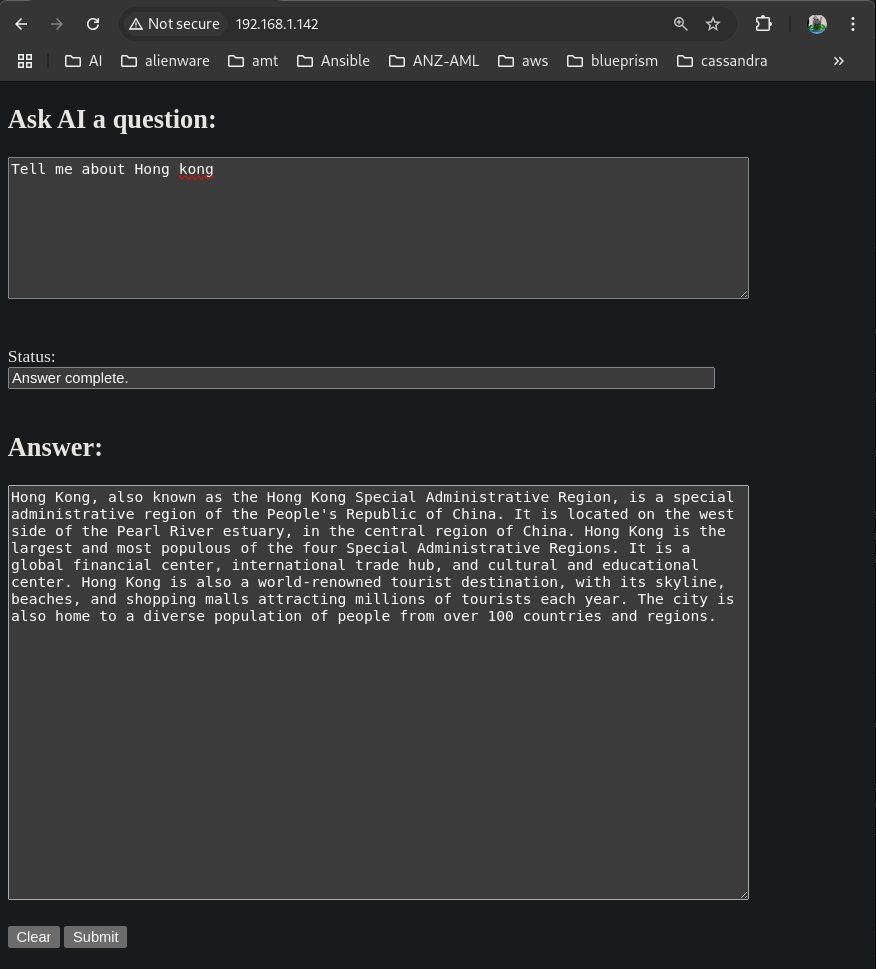

      A web UI complements the the Voice Assistant in the following use cases:
      • for a long answer to a question, it takes the Voice Assistant a long time to go through it using speech. It will be much quicker if the answer is displayed as text but not on the small screen of the M5Stack Core processor
      • I want to copy all or part of the answer and use it somewhere else
      • the web UI and voice assistant can be used concurrently
      My Youtube video shows the web and voice UI working independently and concurrently.
