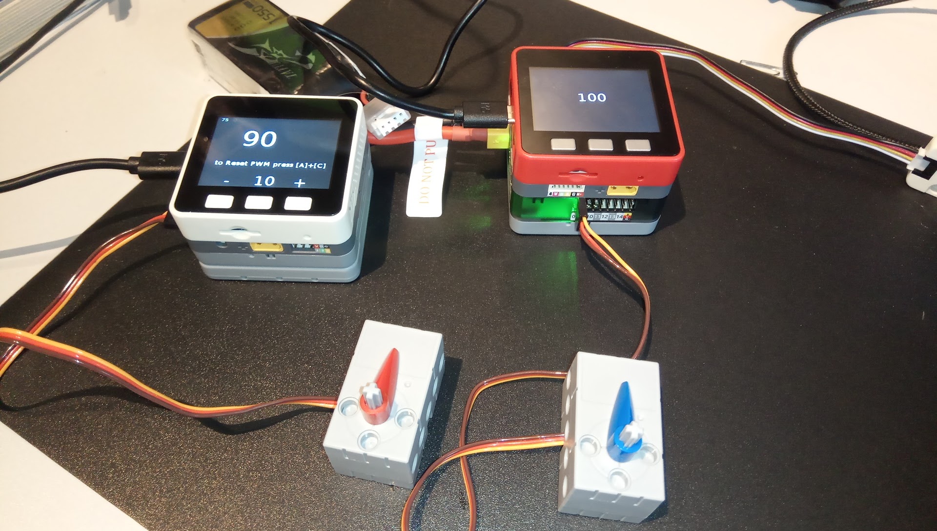

I'm currently testing the Servo2 module and found a problem with the positioning of the servo.
With Servo2 the center position seems to be at 100° and not at 90° as in the older Servo module. I've checked this with different servos.
It seems also that the lowest pulse width provided by Servo2 is lower than 500 micros (nomally the range should be 500 to 2500 micros)
Is there any chance to fix this?
