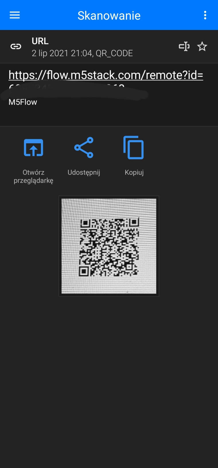

                @felmue said in UIFlow 1.8.0:
                Hello @m5stack
                thank you for the new version. I've tried the REMOTE+ but when I scan the QR code with my phone the browser returns a 404 - not found - error.
                Have you guys actually tested this stuff???
                In addition m5f files saved with UIFlow 1.7.8 no longer load with UIFlow 1.8.0. And yes, I am using Chrome and yes, I've cleared the cache.
                Looks like yet another regression. I must assume you still don't do any regression tests at all, or do you?
                Please fix.
                Thanks
                Felix

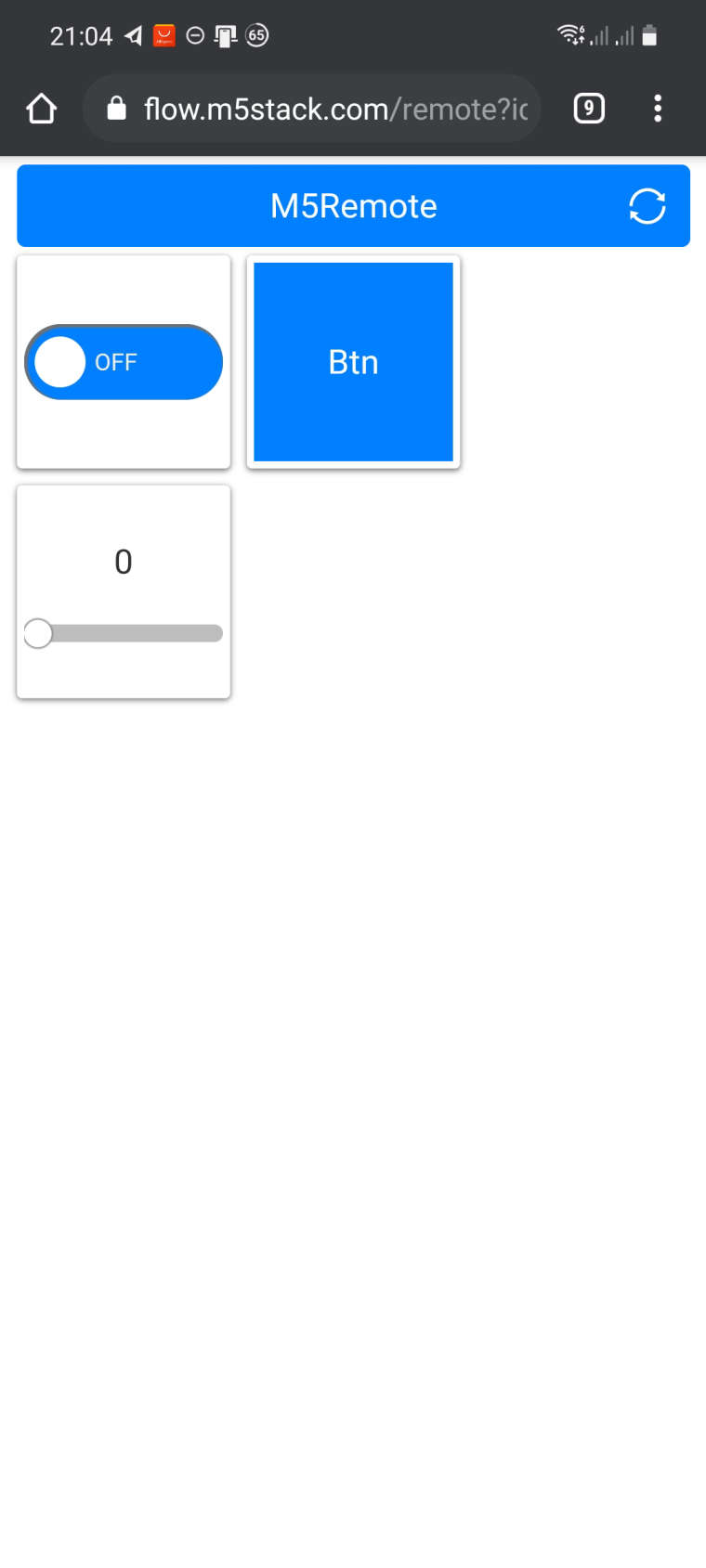

                Its working for me. From uiflow and from core2 screen.
                0_1625252821268_Screenshot_20210702-210501_QR & Barcode Scanner.jpg 0_1625252828626_Screenshot_20210702-210425_Chrome.jpg

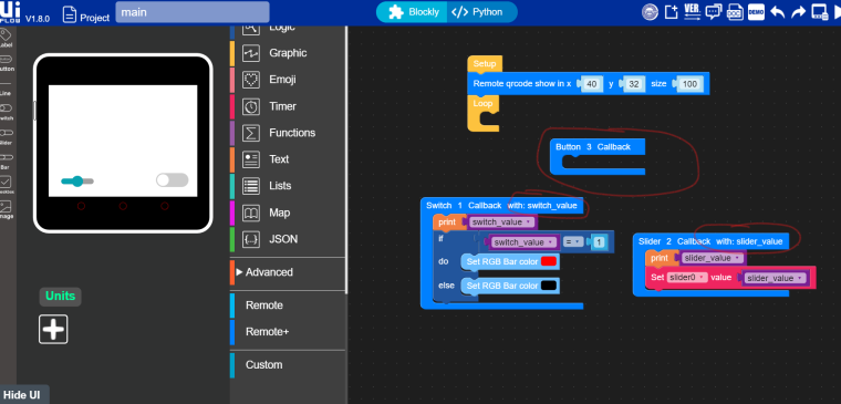

                  Bug#2 Remote+ missing variable in Button
                  m5stackM 1 Reply Last reply Reply Quote 0

                    • felmueF Online
                      felmue
                      Hello @Mati
                      thank you very much for letting us know. I've just retried REMOTE+ myself and this time it worked. Either something went wrong the first time or maybe M5Stack fixed something already.
                      Thanks
                      Felix

                                @mati actually that just a button. this function just like a callback, each time you press it, the function exec one time. so it can without the variable.
