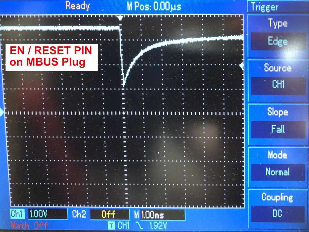

      I have bought now two M5Stack Fire modules from two suppliers and have issues programing them in a stable manner wit UI Flow.
      One of tham has a chance of ~10% to get programed, the other ~50%.
      I have read the common post related to that issue and the recomendations to put a capacitor on the EN / RESET Line.
      For me the issue is quite clear because every time I cannot program the board I see that the board got a reset. I have taken a osciliscope picture of the signal from the MBUS Plug and can see a pulse on the RESET line on each program attempt. If the pulse gets too low I have a reset and the programming fails.

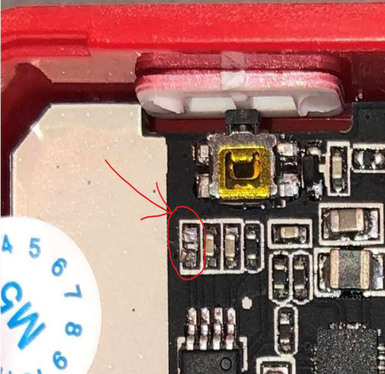

      I had also a closer look at the PCB and recognized a "missing" component near the RESET button:
      Is this a hardware issue? Why two of the boards from different sources have the same issue.
        The part is C44 100nF.
        Removed on M5Stack Fire to prevent Nois.
        See below.
        Parts arrangement of M5Stack
        https://macsbug.wordpress.com/2020/04/01/parts-arrangement-of-m5stack/
        1. GPIO23 Radiation, Audio Amp
          Audio Amp:
          _ 2. C44 to U9-4: BASIC and GRAY are connected. FIRE is not connected.
          FIRE: Noise is reduced by removing C44 from U9-4.

          Hello macsbug,
          thanks you for the detailed information, so the component should be missing on fire devices.
