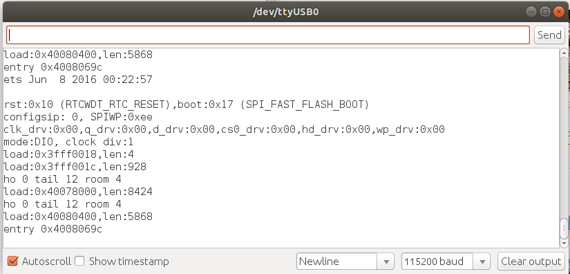

      I am having some issue with a newly purchased M5Stack Grey and Basic. For the M5Stack Grey, I could connect to it and upload the program to it, and it will boot up successfully. However sometimes after I disconnected it and turned it off, the next time I connect it back to my laptop USB port, or connect it to any USB port from power bank, it will not boot up. Instead, it will have some buzz noise, and the UART connection of it output this, "SPI_FAST_FLASH_BOOT" shown in the screenshot below.
      It can be solved by turning the M5Stack Grey on first, then connect it to my laptop USB, then I can boot it up. Can anyone tell me what's the problem was? I am very worried that the M5Stack Grey will slowly unable to connected to like my M5Stack Basic
