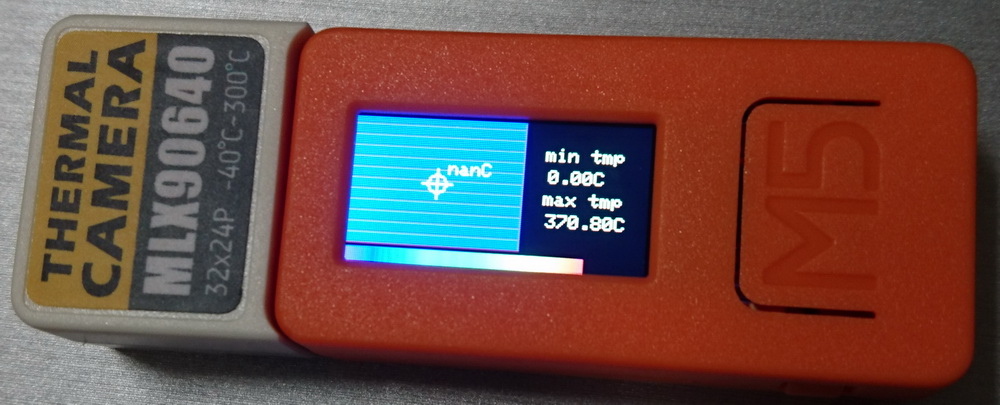

      I ordered the M5Stack C and also the HAT MLX 90640. Then I installed Arduino 1.8.9. And downloaded the example M5Stack C / Hat / MLX 90640. But the only thing I get displayed is this picture.
      In the serial monitor I get the following text : " No ack read" in between then "Get Frame error: -8 /24.000000, 35.000000 " and then again the first text.
      Is the module possibly defective or what am I doing wrong?

        Do you get the same result when using the precompiled firmware from this page?
        https://docs.m5stack.com/#/en/hat/hat-thermal
        Easy Downloader.
        SkinkS 1 Reply Last reply Reply Quote 0
        • SkinkS
          Skink @ajb2k3
          @ajb2k3
          thank you , it work´s
