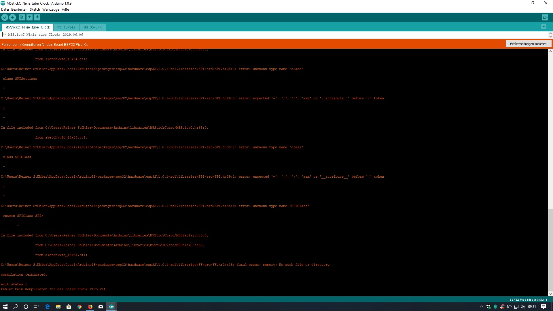

          I downloaded the program here : "https://github.com/McOrts/M5StickC_Nixie_tube_Clock" and installed it via Arduino.
          But with me comes only the following error message see picture and the clock does not work.
          What am I doing wrong or what is missing !

              Arduino: 1.8.9 (Windows 10), Board: "M5Stick-C, Default, 115200, None"
              In file included from C:\Users\Reiner St�hler\AppData\Local\Arduino15\packages\esp32\hardware\esp32\1.0.2\cores\esp32/Print.h:27:0,
                               from C:\Users\Reiner St�hler\AppData\Local\Arduino15\packages\esp32\hardware\esp32\1.0.2\cores\esp32/Stream.h:26,
                               from C:\Users\Reiner St�hler\AppData\Local\Arduino15\packages\esp32\hardware\esp32\1.0.2\libraries\Wire\src/Wire.h:31,
                               from C:\Users\Reiner St�hler\Documents\Arduino\libraries\M5StickC\src/M5StickC.h:67,
                               from sketch\vfd_18x34.c:3:
              C:\Users\Reiner St�hler\AppData\Local\Arduino15\packages\esp32\hardware\esp32\1.0.2\cores\esp32/Printable.h:25:1: error: unknown type name 'class'
               class Print;
              C:\Users\Reiner St�hler\AppData\Local\Arduino15\packages\esp32\hardware\esp32\1.0.2\cores\esp32/Printable.h:33:1: error: unknown type name 'class'
               class Printable
              C:\Users\Reiner St�hler\AppData\Local\Arduino15\packages\esp32\hardware\esp32\1.0.2\cores\esp32/Printable.h:34:1: error: expected '=', ',', ';', 'asm' or '__attribute__' before '{' token
              In file included from C:\Users\Reiner St�hler\AppData\Local\Arduino15\packages\esp32\hardware\esp32\1.0.2\cores\esp32/Stream.h:26:0,
              C:\Users\Reiner St�hler\AppData\Local\Arduino15\packages\esp32\hardware\esp32\1.0.2\cores\esp32/Print.h:34:1: error: unknown type name 'class'
               class Print
              C:\Users\Reiner St�hler\AppData\Local\Arduino15\packages\esp32\hardware\esp32\1.0.2\cores\esp32/Print.h:35:1: error: expected '=', ',', ';', 'asm' or '__attribute__' before '{' token
              In file included from C:\Users\Reiner St�hler\AppData\Local\Arduino15\packages\esp32\hardware\esp32\1.0.2\libraries\Wire\src/Wire.h:31:0,
              C:\Users\Reiner St�hler\AppData\Local\Arduino15\packages\esp32\hardware\esp32\1.0.2\cores\esp32/Stream.h:38:1: error: unknown type name 'class'
               class Stream: public Print
              C:\Users\Reiner St�hler\AppData\Local\Arduino15\packages\esp32\hardware\esp32\1.0.2\cores\esp32/Stream.h:38:13: error: expected '=', ',', ';', 'asm' or '__attribute__' before ':' token
              In file included from C:\Users\Reiner St�hler\Documents\Arduino\libraries\M5StickC\src/M5StickC.h:67:0,
              C:\Users\Reiner St�hler\AppData\Local\Arduino15\packages\esp32\hardware\esp32\1.0.2\libraries\Wire\src/Wire.h:38:1: error: unknown type name 'class'
               class TwoWire: public Stream
              C:\Users\Reiner St�hler\AppData\Local\Arduino15\packages\esp32\hardware\esp32\1.0.2\libraries\Wire\src/Wire.h:38:14: error: expected '=', ',', ';', 'asm' or '__attribute__' before ':' token
              C:\Users\Reiner St�hler\AppData\Local\Arduino15\packages\esp32\hardware\esp32\1.0.2\libraries\Wire\src/Wire.h:136:8: error: unknown type name 'TwoWire'
               extern TwoWire Wire;
              C:\Users\Reiner St�hler\AppData\Local\Arduino15\packages\esp32\hardware\esp32\1.0.2\libraries\Wire\src/Wire.h:137:8: error: unknown type name 'TwoWire'
               extern TwoWire Wire1;
              In file included from C:\Users\Reiner St�hler\Documents\Arduino\libraries\M5StickC\src/M5StickC.h:68:0,
              C:\Users\Reiner St�hler\AppData\Local\Arduino15\packages\esp32\hardware\esp32\1.0.2\libraries\SPI\src/SPI.h:28:1: error: unknown type name 'class'
               class SPISettings
              C:\Users\Reiner St�hler\AppData\Local\Arduino15\packages\esp32\hardware\esp32\1.0.2\libraries\SPI\src/SPI.h:29:1: error: expected '=', ',', ';', 'asm' or '__attribute__' before '{' token
              C:\Users\Reiner St�hler\AppData\Local\Arduino15\packages\esp32\hardware\esp32\1.0.2\libraries\SPI\src/SPI.h:38:1: error: unknown type name 'class'
               class SPIClass
              C:\Users\Reiner St�hler\AppData\Local\Arduino15\packages\esp32\hardware\esp32\1.0.2\libraries\SPI\src/SPI.h:39:1: error: expected '=', ',', ';', 'asm' or '__attribute__' before '{' token
              C:\Users\Reiner St�hler\AppData\Local\Arduino15\packages\esp32\hardware\esp32\1.0.2\libraries\SPI\src/SPI.h:86:8: error: unknown type name 'SPIClass'
               extern SPIClass SPI;
              In file included from C:\Users\Reiner St�hler\Documents\Arduino\libraries\M5StickC\src/M5Display.h:5:0,
                               from C:\Users\Reiner St�hler\Documents\Arduino\libraries\M5StickC\src/M5StickC.h:69,
              C:\Users\Reiner St�hler\AppData\Local\Arduino15\packages\esp32\hardware\esp32\1.0.2\libraries\FS\src/FS.h:24:18: fatal error: memory: No such file or directory
              compilation terminated.
              exit status 1
              Fehler beim Kompilieren für das Board M5Stick-C.
              Where are the libraries are must Install ??

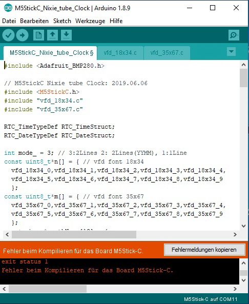

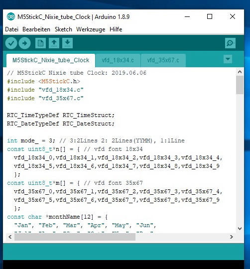

                I need to see a screen shot of the beginning of the sketch with the Include lines please.
                • SkinkS Offline
                  Skink
                  Hello and thank you very much, here is the screenshot for you. M5Stickc is installed according to the M5stack manual: "https://docs.m5stack.com/#/en/quick_start/m5stickc/m5stickc_quick_start_with_arduino_Windows" and both files are loaded automatically when I load the "M5StickC_Nixie_tube_Clock.ino".
                  Don't understand why this doesn't work, so it's in the description of the Nixi Clock !!
                  Greetings skink

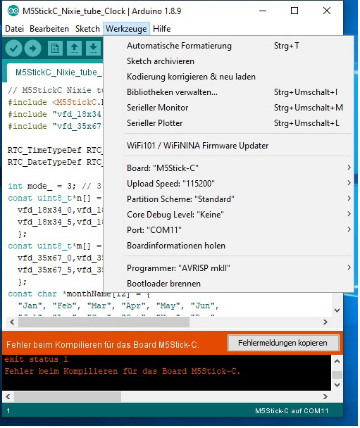

                    Without wanting to anticipate @ajb2k3 :
                    Your first screenshot says "Fehler beim Kompilieren für das Board ESP32 Pico Kit" and this board is also listed in the lower right corner of the screenshot.
                    I think, that you should first change the board-Type in the Arduino IDE under 'Tools/Werkzeuge' - 'Board/???' - .... to: 'M5Stick-C' and than try to compile again.
                    May be (and I hope) it helps ...

                      0_1564920326669_Nixi.jpg Hello,
                      unfortunately no, I reinstalled everything and now I'm using M5Stick-C and also the transfer parameters are correct but it doesn't happen at all.
                      I'm really helpless what's missing or why he can't compile ???????

                      • ajb2k3A Offline
                        ajb2k3 @Skink
                        @skink said in M5StickC Nixie tube Clock:
                        Grus skink
                        When you change something like adding library you need to restart arduino
                        Try upload speed 150000 as that was what mine was set to when I installed it.
                        BTW are you suing the provided black usb cable?

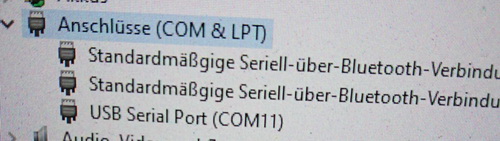

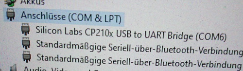

                        • SkinkS Offline
                          Skink @ajb2k3
                          @ajb2k3 Hello @all,
                          I've done everything like this, I also have a few more library´s.
                          But the program doesn't want to run on the M5Stick-C.
                          It is always only shown to me that an error occurred during compiling for the board M5Stick-C.
                          The program stops and that was it.
                          Means I don't get the program complicated at all, so I didn't even install it.
                          Can someone send me the link to the program again or send me a copy.
                          I am really in despair, because all examples from the Arduino environment for the M5Stick-C can be installed and run problem-free!
                          Greetings Skink

                            • ajb2k3A Offline
                              ajb2k3
                              I'm not sure what could be wrong as I have just compiled it
                              #include <M5StickC.h>
                              #include "vfd_18x34.c"
                              #include "vfd_35x67.c"
                              RTC_TimeTypeDef RTC_TimeStruct;
                              RTC_DateTypeDef RTC_DateStruct;
                              int mode_ = 3; // 3:2Lines 2: 2Lines(YYMM), 1:1Line
                              const uint8_t*n[] = { // vfd font 18x34
                                vfd_18x34_0,vfd_18x34_1,vfd_18x34_2,vfd_18x34_3,vfd_18x34_4,
                                vfd_18x34_5,vfd_18x34_6,vfd_18x34_7,vfd_18x34_8,vfd_18x34_9
                              const uint8_t*m[] = { // vfd font 35x67
                                vfd_35x67_0,vfd_35x67_1,vfd_35x67_2,vfd_35x67_3,vfd_35x67_4,
                                vfd_35x67_5,vfd_35x67_6,vfd_35x67_7,vfd_35x67_8,vfd_35x67_9
                              const char *monthName[12] = {
                                "Jan", "Feb", "Mar", "Apr", "May", "Jun",
                                "Jul", "Aug", "Sep", "Oct", "Nov", "Dec"
                              void setup(void){
                                pinMode(M5_BUTTON_HOME, INPUT);
                                M5.Lcd.fillScreen(BLACK);
                                M5.Lcd.setRotation(1);
                                M5.Axp.ScreenBreath(10);             // 7-15
                                // rtc setup start ---------------------------------------------
                                String pt = (__DATE__ " " __TIME__); // PC DATE TIME READ
                                //000000000011111111112  Read data
                                //012345678901234567890
                                //Jun  6 2019 07:20:41
                                char m1[3]; int  m2; // Month conversion ( Jun to 6 )
                                (pt.substring(0,3)).toCharArray(m1,4);
                                for (int mx = 0; mx < 12; mx ++) {
                                  if (strcmp(m1, monthName[mx]) == 0){m2 = mx + 1; break;}
                                RTC_DateTypeDef DateStruct;         // Month, Date, Year
                                DateStruct.Month   = m2;
                                DateStruct.Date    = (pt.substring(4, 6)).toInt();
                                DateStruct.Year    = (pt.substring(7,11)).toInt();
                                M5.Rtc.SetData(&DateStruct);
                                RTC_TimeTypeDef TimeStruct;         // Hours, Minutes, Seconds
                                TimeStruct.Hours   = (pt.substring(12,14)).toInt();
                                TimeStruct.Minutes = (pt.substring(15,17)).toInt();
                                TimeStruct.Seconds = (pt.substring(18,20)).toInt();
                                M5.Rtc.SetTime(&TimeStruct);
                                // rtc setup end -----------------------------------------------
                              void loop(void){
                                if(digitalRead(M5_BUTTON_HOME) == LOW){
                                  if (mode_ == 3){mode_ = 1;M5.Lcd.fillScreen(BLACK);return;}
                                  if (mode_ == 2){mode_ = 3;M5.Lcd.fillScreen(BLACK);return;}
                                  if (mode_ == 1){mode_ = 2;M5.Lcd.fillScreen(BLACK);return;}
                                if ( mode_ == 3 ){ vfd_3_line();}   // hh,mm,ss

                              I'm using Arduino 1.8.9 to compile fresh from github.
                              Have you tried updating your M5Stack vfd Libraries?
                              it looks like you libs are 1.0.2 where as I am using 1.22

                                Thank you @ajb2k3 ,
                                The program is now compiled and transferred.Thank you for the Link
                                Afterwards the time appears for one second when resetting the M5Stick-C, then the screen is black.

                                    the battery is full, even if I leave the M5Stick-C connected to the laptop, the Nixi clock disappears after a second and the screen stays black, but you can still see the backlight.
                                    What I haven't understood about the manual so far is the following part:
                                    Update Nixie Tube images
                                    Execute the lcd-image-converter.exe include in this repository.
                                    " Png or Jpg is read from File->Open Menu. The image will be displayed when loaded.
                                    Select: Option->Conversions Menu. The top Preset: selects "Color R5G6B5".
                                    Select: Image tap and select “8 bit” for Block size :. Press "OK".
                                    The example "vfd_35x67_8.c" is output by "Convert ..." in File-Convert Menu. Know in advance the destination path. Tick: Import All Images You can also output all the images with “Convert ... all”.
                                    Edit .c converted file. You will get an error as it is, so fix it with your editor.
                                    " Change: "Static const uint8_t image_data_vfd_35x67 [4690] = {" at the top of the file deleting "image_data_" as result of "static const uint8_t vfd_35x67_8 [4690] = {".
                                    At the bottom of delete de entire line: "const tImage vfd_35x67 = {image_data_vfd_35x67, 35, 67, 8};
                                    Save the example "vfd_35x67_8".c***
                                    When I load the file M5StickC-Nixie-tube_clock.ino into Arduino, both files vfd_1834.c and vfd_3567.c are loaded automatically.
                                    Where or what should I change !
                                    Don't understand this !
                                    Greetings Reiner
