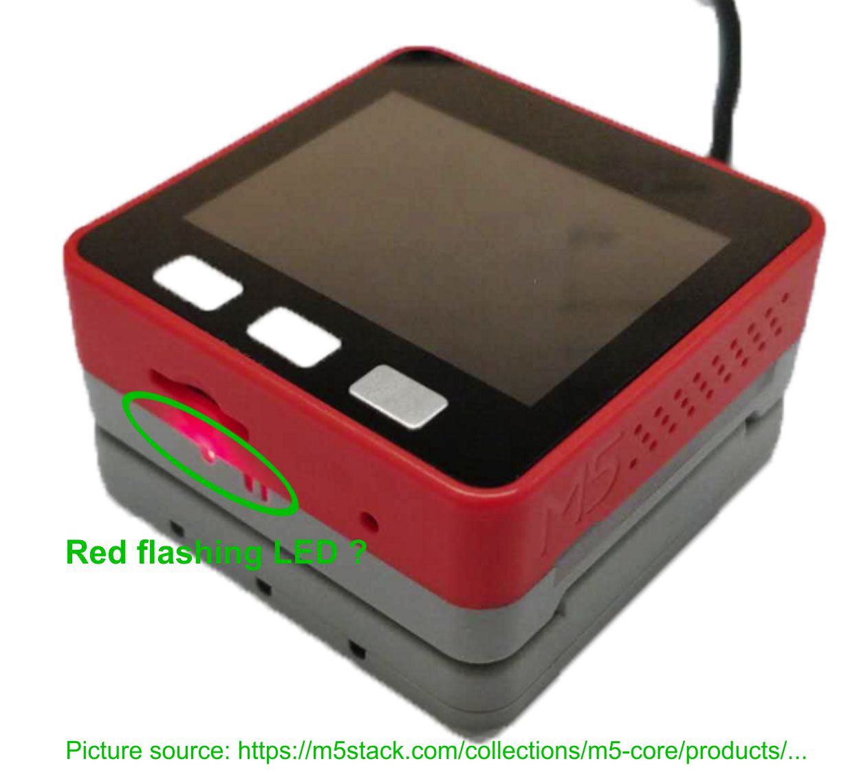

      Hi - another beginners question:
      What is indicated by the red LED below the SD-slot of the M5Stack-FIRE?
      Sometimes it is on, sometimes it is off, sometimes it flashes.
      Flashing is done with varying on-time and varying off-time.
      Thanks - grelm

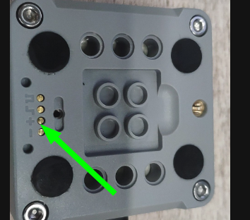

        • H
          heybin
          if use it in Charging, it will flicker
          • grelmG
            grelm
            Hi @heybin !
            What do you want to show us with the picture: flickering due to problems with contacts?
            Do you know what the meaning is of:
            1. flashing? ( = 1s on > 1s off > 1s on > and so on: charging?)
            2. continiously OFF?
            3. continiously ON?
            What I noticed so far:
            a) USB charging cable connected to M5GO CHG Base and M5GO CHG Base attached to M5GO Base: LED is flashing and obviously charging
            b) M5GO disconnected from M5GO Base: LED = ON for 30 seconds , than OFF, but FIRE is still on and operational (Power from internal Lipo Battery?)
            c) M5GO CHG Base attached to M5GO Base, but no power on USB-Cable: same behaviour as item b) above. (Power from internal Lipo battery AND/OR CHG Base Battery?)
