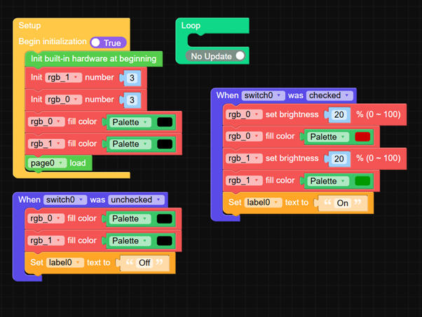

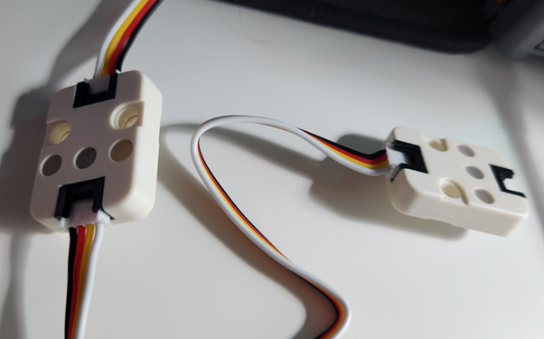

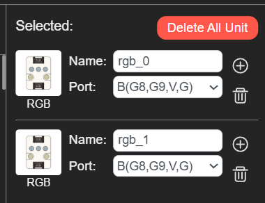

      I chained 2 RGB units to coreS3 (UIFlow 2.4.2)
      and run this:

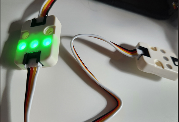

      but the code does not work
      Any ideas what is wrong and how to solve it.
      Thanks
      • felmueF Offline
        felmue @JohnSal
        Hello @JohnSal
        I think you only need to add one RGB unit but with number set to 6 instead of 3.
