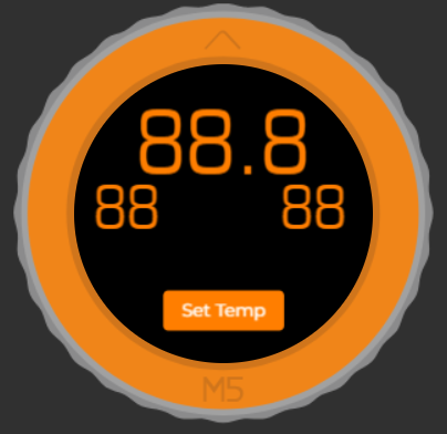

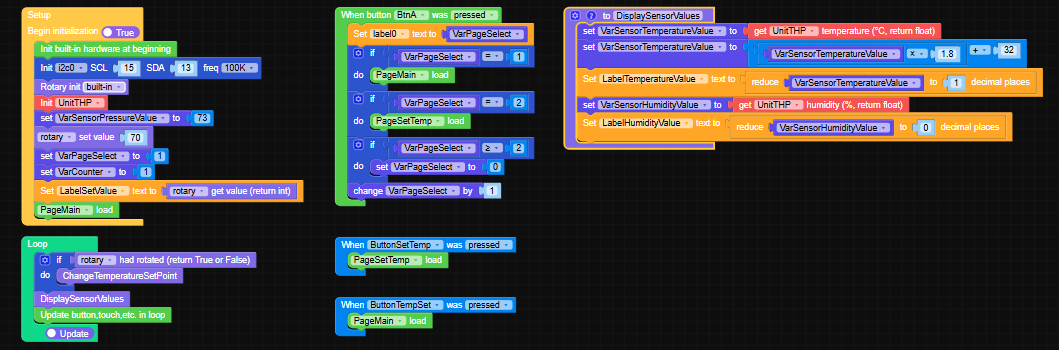

      • pressing the built-in button on the ring (BtnA) will sometimes "function"
      • pressing the software buttons will respond quickly without problem
      • if I remove the "DisplaySensorValues" call then BtnA works expected
      What I think is the problem:
      • it seems that the software buttons from UIFLOW2 has a higher priority than hardware BtnA
      • this problem does not exist with the newer M5Dial V1.1 with a faster processor
      Thoughts:
      • am I missing something easy?
      • is there a way to make the BtnA "faster"
      Workarounds:
      • I will look at not updating the display as often by adding a delay by counting ticks
      • upgrade to the M5Dial V1.1 (ugh, I need 5 more so not the best solution)
