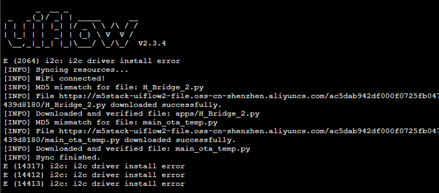

      I use UIFOLW 2 version 2.3.4 and Core basic.
      I have purchased several Unit Hbridge modules with version 1.1.
      When I run the "Set" commands, they work correctly, or so it seems.

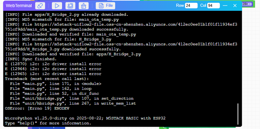

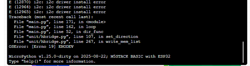

      When I add a "Get" command, the error shown on the screen appears.
      If I use UIFOLW 2 version 2.3.5, the battery data is incorrect.

      If I run this code, which is the one I'm interested in, I get the error shown on the screen.
      Error in the image

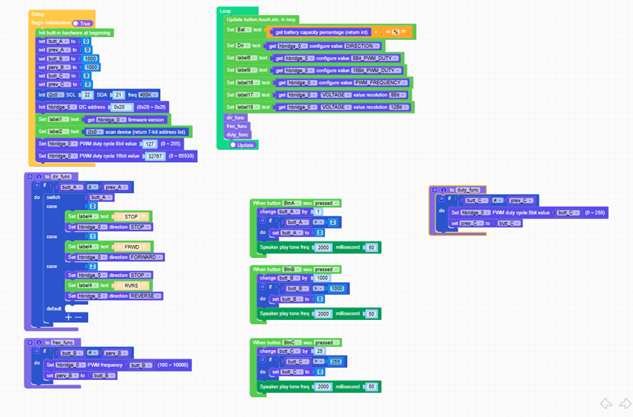

            This is de proyect.
            Este es el proyecto
            https://uiflow2.m5stack.com/?pkey=b0d334240ade47ed9da0f31549677850

              hmm, not completely sure what the issue is. I am running your example code in UIFlow2 v2.3.7 and when I press BtnA it cycles through Frwd, Rvrs and Stop just fine.
              An attached battery seems to show the correct battery state as well.
              Could you please cut down your example to the minimum showing the issue you are describing?

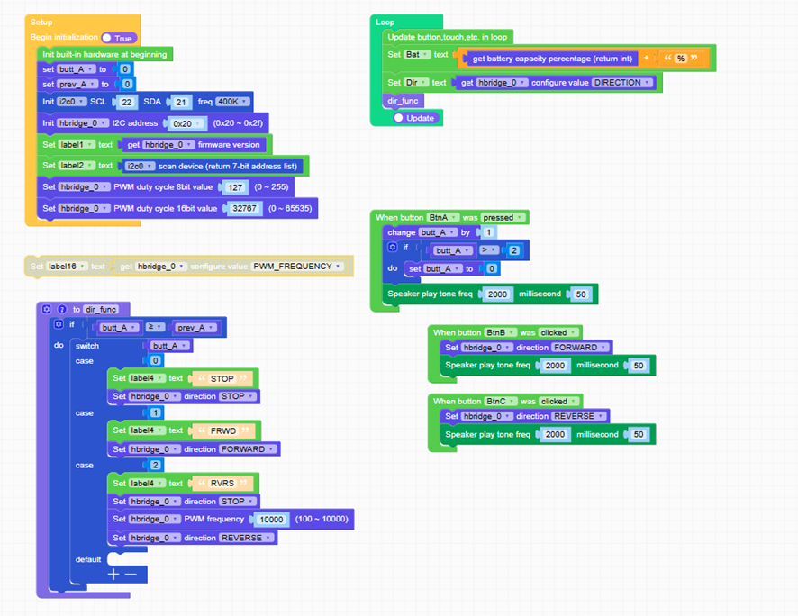

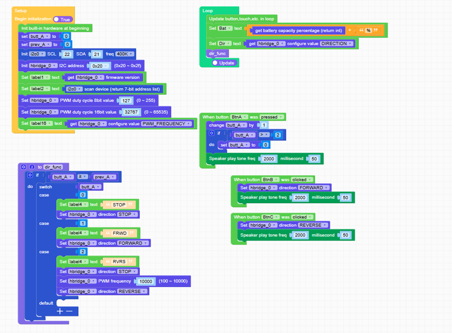

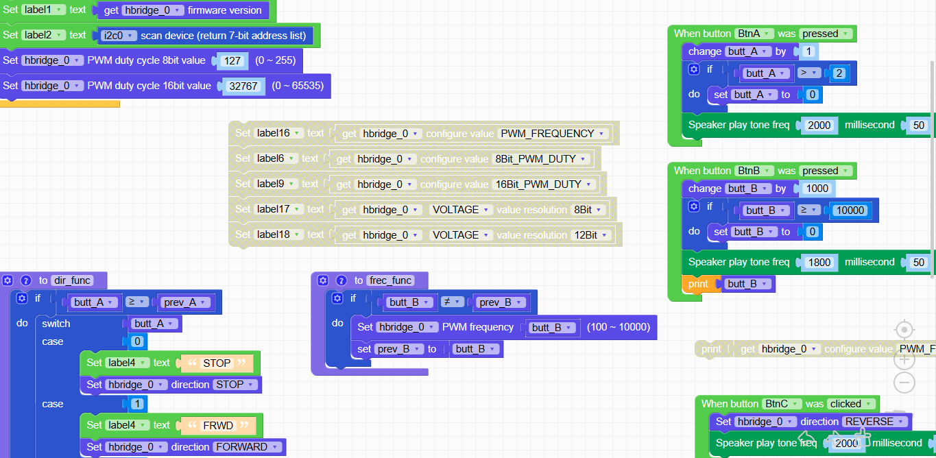

                Thanks for replying. I'm currently using UIFlow2 v2.3.7. If I remove the "GET" commands, as shown in the image, it works without displaying these values, obviously.
                I'm using Core Basic with the latest version UIFlow2 v2.3.7. Could that be related?
                But when I add a single "GET" command, this error occurs at startup.
