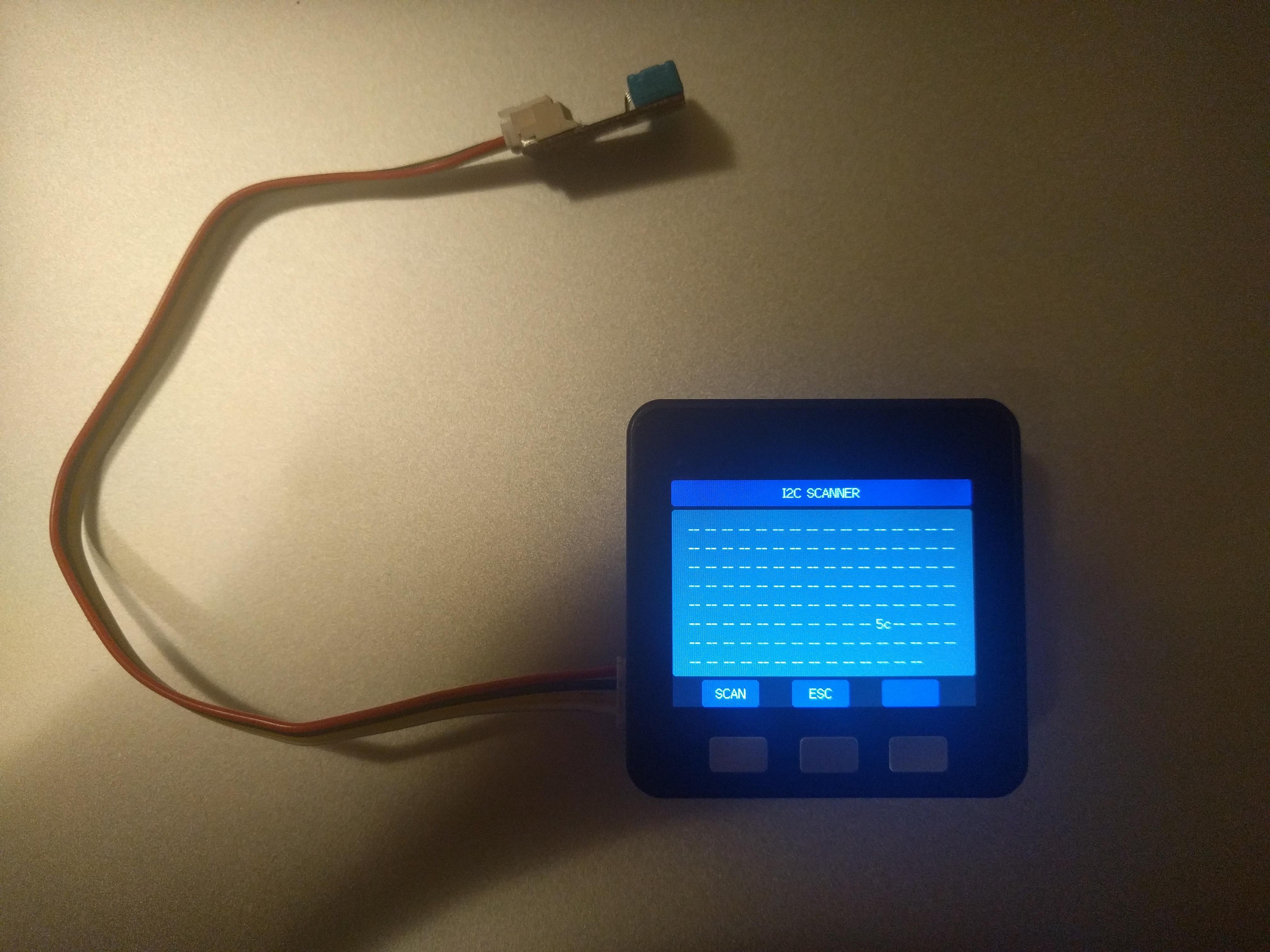

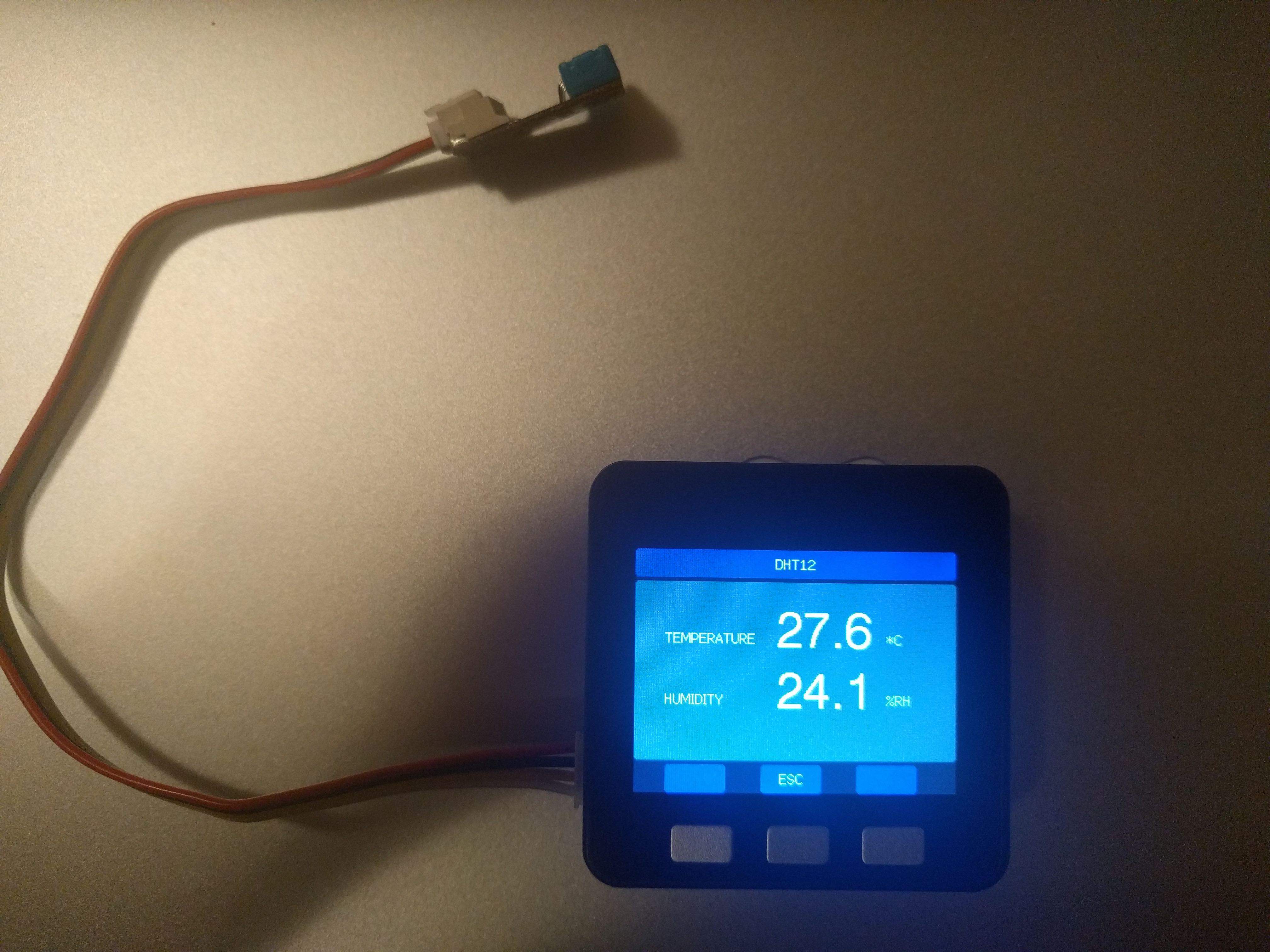

      Fast and dirty minimalist application menu for M5Stack.
      Integrated applications: DHT12 - Temperature / Humidity Stopwatch I2C scanner Bluetooth BLE Beacon Simulator (iBeacon, Eddystone TLM + URL, ALTBeacon)
      Settings: display backlight
      Other: sleep mode

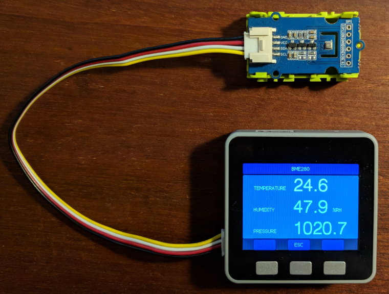

            Hi @TomSuch , I like your SAM, have cloned it and extend it a bit.
            I have add an APP - appBME280, to read a Grove - Barometer Sensor.
            M5Stack-SAM ext. version
            appBME280
            T W 3 Replies Last reply Reply Quote 3
            • T Offline
              TomSuch @SunWukong
              @sunwukong Super, good work. Thank you
              SunWukongS 1 Reply Last reply Reply Quote 1

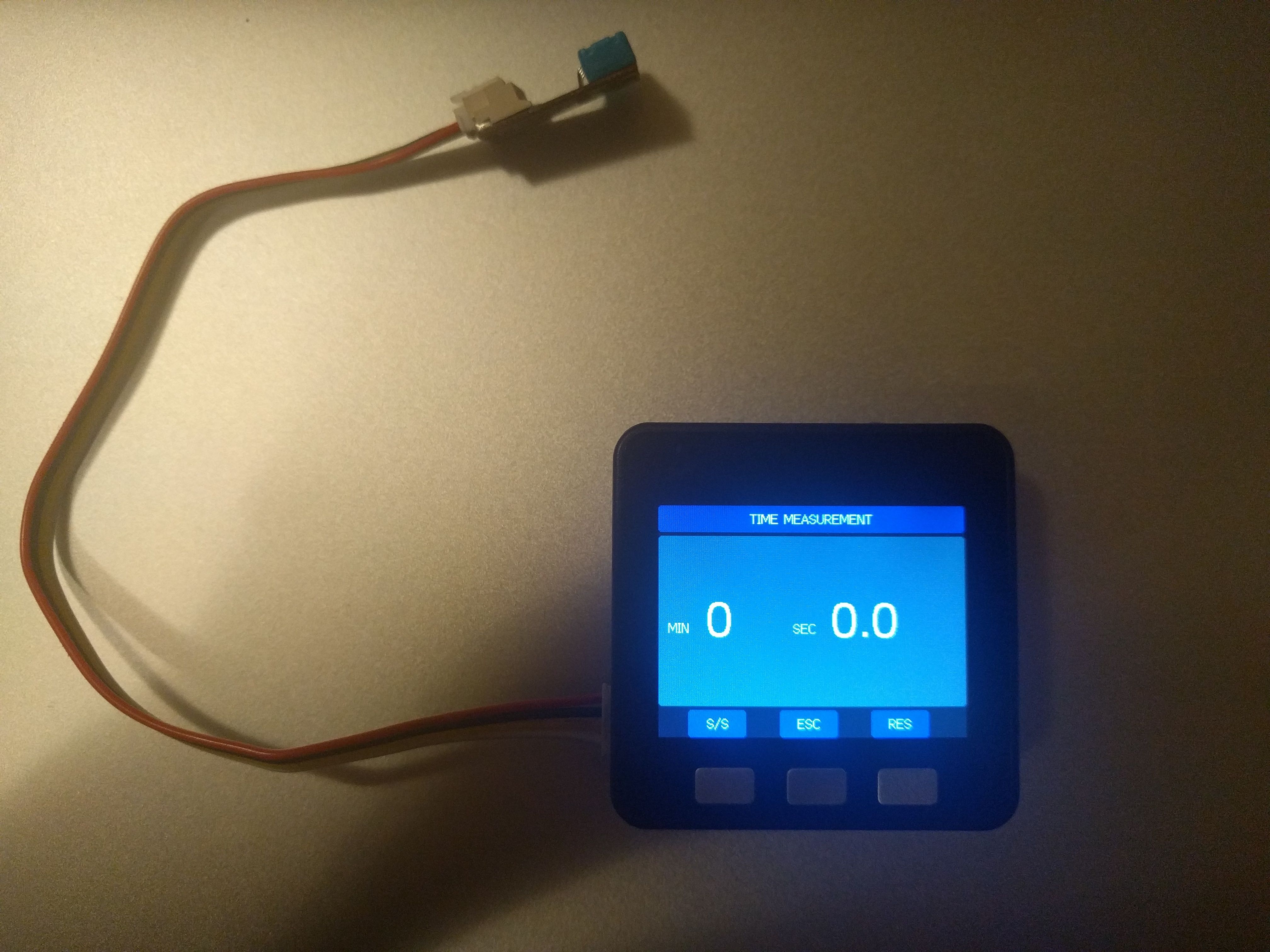

                                    Can You modify TIM MEASUREMENT APP?
                                    S/S button should 1.START->2.STOP->3.START without reset between 2 and 3 step...(something like continous measurement with pause). For reset value we have RES button
                                    MY GITHUB: https://github.com/reaper7/
                                    T 1 Reply Last reply Reply Quote 1
                                    • T Offline
                                      TomSuch @reaper7
                                      @reaper7 Hi, thanks for the subject. I edited the application of the stopwatch and is already out. Regards...

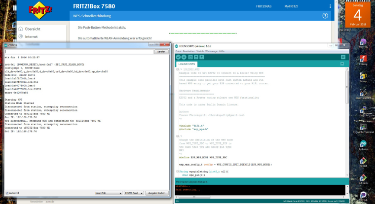

                                      • JJJ Offline
                                        JJ
                                        T 2 Replies Last reply Reply Quote 0
                                        • T Offline
                                          TomSuch @JJ
                                          @jimit Hi, good work. But I did not find the code on your git ...
                                          JJJ 1 Reply Last reply Reply Quote 0
                                          • JJJ Offline
                                            JJ @TomSuch
                                            @tomsuch
                                            Oops... sorry bout that. Have added them now....
                                            T 1 Reply Last reply Reply Quote 0
