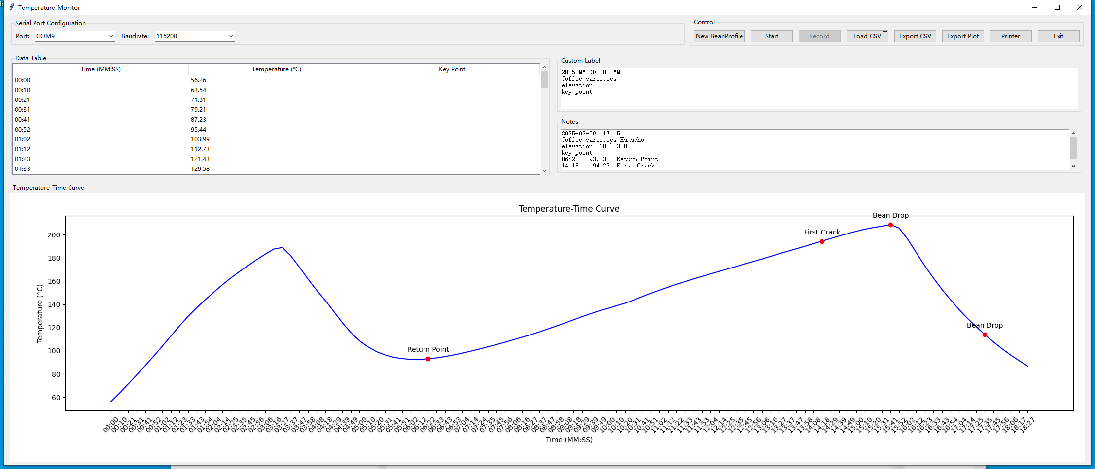

      (3) Background Monitoring and Printing Program: Using the Python language, a monitoring and printing program for coffee bean temperature during roasting was written for Windows. Besides monitoring the bean temperature in real-time, it can also mark key points (e.g., Turning Point/Turnaround, First Crack, Drop Point), add simple notes, and finally print a record label of the roasting parameters via a serial thermal printer. This label is stuck onto the container of the roasted beans, completing a full coffee roasting and data recording session.

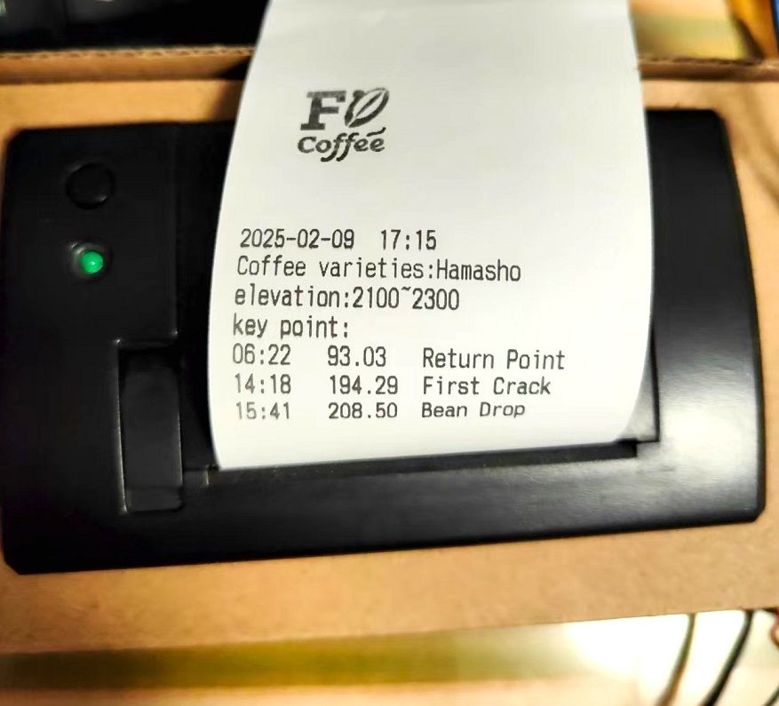

      Step 1: Thermal Printer Part: The TTL level interface of the 58mm thermal printer is connected to the PC via a USB-TTL converter module.
      Step 2: Temperature Data Acquisition: AtomS3 --> PC via USB. The temperature data is sent in a dual transmission mode: sent to the glasses via ESP-NOW and sent to the PC via USB (serial).
      Step 3: PC GUI design and code.

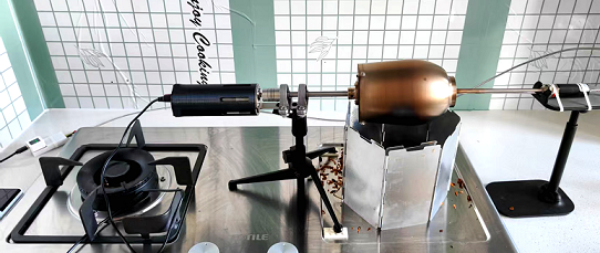

      (4) Semi-Direct Flame Gas Roaster: This is not made by me. It is used for roasting green coffee beans. Our coffee roasting glasses, used with this roaster, allow for roasting 100g batches of coffee beans at home, enjoying the fun of DIY coffee beans.

      import tkinter as tk
      from tkinter import ttk, scrolledtext, messagebox, filedialog
      import serial
      import serial.tools.list_ports
      import threading
      import time
      import csv
      import matplotlib.pyplot as plt
      from matplotlib.backends.backend_tkagg import FigureCanvasTkAgg
      from datetime import datetime
      from Adafruit_Thermal import Adafruit_Thermal
      from tkinter import Toplevel
      import os
      from PIL import Image
      # 全局变量
      is_running = False
      is_recording = False
      serial_port = None
      data = []
      last_data_time = 0
      fig, ax = None, None
      canvas = None

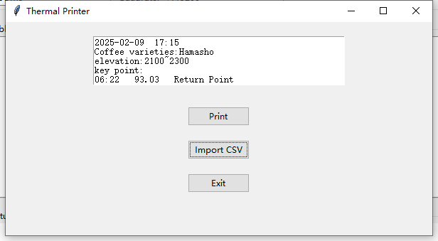

      #添加打印窗口类:
      class PrinterApp:
          def __init__(self, master):
              self.window = tk.Toplevel(master)
              self.window.title("Thermal Printer")
              self.window.geometry("600x300")
              self.printer_initialized = False
              self.printer = None
              self.label = tk.Text(self.window, width=50, height=5, wrap=tk.WORD)
              self.label.pack(pady=20)
              self.print_button = ttk.Button(self.window, text="Print", command=self.print_text)
              self.print_button.pack(pady=10)
              self.import_button = ttk.Button(self.window, text="Import CSV", command=self.import_csv)
              self.import_button.pack(pady=10)
              self.exit_button = ttk.Button(self.window, text="Exit", command=self.exit_app)
              self.exit_button.pack(pady=10)
              # Initialize printer
              self.init_printer()
          def init_printer(self):
              Initialize the thermal printer

          def print_image(self, image_path):
              if not self.printer_initialized:
                  messagebox.showerror("Printer Error", "Printer is not initialized")
                  return
              try:
                  image = Image.open(image_path)
                  if image.mode != '1':
                      image = image.convert('1')
                  width = image.size[0]
                  height = image.size[1]
                  if width > 384:
                      width = 384
                  rowBytes = (width + 7) // 8
                  bitmap = bytearray(rowBytes * height)
                  pixels = image.load()
                  for y in range(height):
                      n = y * rowBytes
                      x = 0
                      for b in range(rowBytes):
                          sum = 0
                          bit = 128
                          while bit > 0:
                              if x >= width: break
                              if pixels[x, y] == 0:
                                  sum |= bit
                              x += 1
                              bit >>= 1
                          bitmap[n + b] = sum
                  self.printer.printBitmap(width, height, bitmap)
                  self.printer.feed(1)
              except Exception as e:
                  messagebox.showerror("Printer Error", f"Failed to print image: {e}")
          def print_text(self):
                  return
              image_path = r"D:\Documents\deepseek\ffcoffee2.bmp"
              if os.path.exists(image_path):
                  self.print_image(image_path)
              else:
                  messagebox.showwarning("Warning", f"Image file not found: {image_path}")
              text_to_print = self.label.get("1.0", tk.END).strip()
              if text_to_print:
                  try:
                      self.printer.println(text_to_print)
                      self.printer.feed(2)
                      messagebox.showinfo("Success", "Image and text printed successfully")
                      messagebox.showerror("Printer Error", f"Failed to print text: {e}")
              else:
                  messagebox.showwarning("Input Error", "Please enter some text to print.")
          def import_csv(self):
              file_path = filedialog.askopenfilename(filetypes=[("CSV files", "*.csv")])
              if file_path:
                  try:
                      with open(file_path, newline='', encoding='utf-8') as csvfile:
                          reader = csv.reader(csvfile)
                          rows = list(reader)
                          for i, row in enumerate(rows):
                              if 'Notes' in row:
                                  notes_index = row.index('Notes')
                                  if i + 1 < len(rows):
                                      notes_value = rows[i + 1][notes_index]
                                      self.label.delete("1.0", tk.END)
                                      self.label.insert("1.0", notes_value)
                                      return
                          messagebox.showwarning("CSV Error", "No 'Notes' column found in the CSV file.")
                      messagebox.showerror("CSV Error", f"Failed to read CSV file: {e}")

                      ax.annotate(key_point, (timestamps[i], temperatures[i]),
                                textcoords="offset points", xytext=(0,10),
                                ha='center')
              ax.set_xlabel("Time (MM:SS)")
              ax.set_ylabel("Temperature (°C)")
              ax.set_title("Temperature-Time Curve")
              plt.xticks(rotation=45)
              # 如果有 Notes 内容,添加到图形的左上角
              if notes:
                  ax.text(0.02, 0.98, notes,
                          transform=ax.transAxes,
                          verticalalignment='top',
                          horizontalalignment='left',
                          fontsize=8,
                          bbox=dict(boxstyle='round', facecolor='white', alpha=0.8))
              # 调整布局以确保所有元素可见
              plt.tight_layout()
              # 保存图形
              fig.savefig(file_path, bbox_inches='tight')
              # 更新显示
              canvas.draw()
              messagebox.showinfo("Success", f"Plot exported to {file_path}")
      def exit_program():
          if serial_port and serial_port.is_open:
              serial_port.close()
          root.quit()
      def mark_key_point(event):
          selected_item = table.selection()
          if selected_item:
              menu.post(event.x_root, event.y_root)
      def mark_return_point():
          update_key_point("Return Point")
      def mark_first_crack():
          update_key_point("First Crack")
      def mark_bean_drop():
          update_key_point("Bean Drop")
      def update_key_point(key_point):
          if selected_item:
              item_data = table.item(selected_item, "values")
              timestamp, temperature, _ = item_data
              table.item(selected_item, values=(timestamp, temperature, key_point))
              for i, row in enumerate(data):
                  if row[0] == timestamp and abs(row[1] - float(temperature)) < 0.001:
                      data[i] = (timestamp, float(temperature), key_point)
                      break
              update_plot()
      def initialize_plot():
          global fig, ax, canvas
          plt.close(fig)
          fig, ax = plt.subplots(figsize=(12, 6))
          canvas.get_tk_widget().pack_forget()
          canvas = FigureCanvasTkAgg(fig, master=plot_frame)
          canvas.draw()
          canvas.get_tk_widget().pack(fill=tk.BOTH, expand=True)
      def copy_selected_data(event):
          selected_items = table.selection()
          if not selected_items:
              return
          copied_data = []
          for item in selected_items:
              values = table.item(item, 'values')
              copied_data.append('\t'.join(str(v) for v in values))
          copied_text = '\n'.join(copied_data)
          root.clipboard_clear()
          root.clipboard_append(copied_text)
          root.update()  # 确保复制到剪贴板
      #def open_printer_window():
      #    PrinterApp(root)
          printer_app = PrinterApp(root)
          root.printer_app = printer_app  # 保持对打印机应用的引用
      # 创建主窗口
      root = tk.Tk()
      root.title("Temperature Monitor")
      root.geometry("1400x800")
      # 顶部框架
      top_frame = ttk.Frame(root)
      top_frame.pack(fill=tk.X, padx=10, pady=5)
      # 串口设置
      port_frame = ttk.LabelFrame(top_frame, text="Serial Port Configuration")
      port_frame.pack(side=tk.LEFT, fill=tk.X, padx=5, expand=True)
      ttk.Label(port_frame, text="Port:").grid(row=0, column=0, padx=5, pady=5)
      port_combobox = ttk.Combobox(port_frame, values=[port.device for port in serial.tools.list_ports.comports()])
      port_combobox.grid(row=0, column=1, padx=5, pady=5)
      port_combobox.set("COM9")
      ttk.Label(port_frame, text="Baudrate:").grid(row=0, column=2, padx=5, pady=5)
      baudrate_combobox = ttk.Combobox(port_frame, values=["9600", "115200", "57600", "38400", "19200"])
      baudrate_combobox.grid(row=0, column=3, padx=5, pady=5)
      baudrate_combobox.set("115200")
      # 控制按钮
      control_frame = ttk.LabelFrame(top_frame, text="Control")
      control_frame.pack(side=tk.RIGHT, fill=tk.X, padx=5)
      new_profile_button = ttk.Button(control_frame, text="New BeanProfile", command=new_bean_profile)
      new_profile_button.pack(side=tk.LEFT, padx=5, pady=5)
      start_stop_button = ttk.Button(control_frame, text="Start", command=toggle_data_reception)
      start_stop_button.pack(side=tk.LEFT, padx=5, pady=5)
      record_button = ttk.Button(control_frame, text="Record", command=toggle_recording, state="disabled")
      record_button.pack(side=tk.LEFT, padx=5, pady=5)
      load_csv_button = ttk.Button(control_frame, text="Load CSV", command=load_csv_file)
      load_csv_button.pack(side=tk.LEFT, padx=5, pady=5)
      export_csv_button = ttk.Button(control_frame, text="Export CSV", command=export_to_csv)
      export_csv_button.pack(side=tk.LEFT, padx=5, pady=5)
      export_plot_button = ttk.Button(control_frame, text="Export Plot", command=export_plot)
      export_plot_button.pack(side=tk.LEFT, padx=5, pady=5)
      printer_button = ttk.Button(control_frame, text="Printer", command=open_printer_window)
      printer_button.pack(side=tk.LEFT, padx=5, pady=5)
      exit_button = ttk.Button(control_frame, text="Exit", command=exit_program)
      exit_button.pack(side=tk.LEFT, padx=5, pady=5)
      # 中间框架
      middle_frame = ttk.Frame(root)
      middle_frame.pack(fill=tk.BOTH, expand=True, padx=10, pady=5)
      # 左侧数据表格
      table_frame = ttk.LabelFrame(middle_frame, text="Data Table")
      table_frame.pack(side=tk.LEFT, fill=tk.BOTH, expand=True, padx=5, pady=5)
      columns = ("Time (MM:SS)", "Temperature (°C)", "Key Point")
      #table = ttk.Treeview(table_frame, columns=columns, show="headings", height=10)
      table = ttk.Treeview(table_frame, columns=columns, show="headings", height=10, selectmode='extended')
      table.heading("Time (MM:SS)", text="Time (MM:SS)")
      table.heading("Temperature (°C)", text="Temperature (°C)")
      table.heading("Key Point", text="Key Point")
      table.pack(side=tk.LEFT, fill=tk.BOTH, expand=True)
      scrollbar = ttk.Scrollbar(table_frame, orient="vertical", command=table.yview)
      scrollbar.pack(side=tk.RIGHT, fill=tk.Y)
      table.configure(yscrollcommand=scrollbar.set)
      # 右侧标签区域
      right_label_frame = ttk.Frame(middle_frame)
      right_label_frame.pack(side=tk.RIGHT, fill=tk.BOTH, expand=True, padx=5, pady=5)
      # 上方自定义标签
      custom_label_frame = ttk.LabelFrame(right_label_frame, text="Custom Label")
      custom_label_frame.pack(fill=tk.BOTH, expand=True, padx=5, pady=5)
      custom_label = tk.Text(custom_label_frame, wrap=tk.WORD, height=5)
      custom_label.insert(tk.END, "2025-MM-DD  HH:MM\nCoffee varieties:\nelevation:\nkey point:")
      custom_label.pack(fill=tk.BOTH, expand=True, padx=5, pady=5)
      # 下方Notes区域
      notes_frame = ttk.LabelFrame(right_label_frame, text="Notes")
      notes_frame.pack(fill=tk.BOTH, expand=True, padx=5, pady=5)
      notes_text = scrolledtext.ScrolledText(notes_frame, wrap=tk.WORD, height=5)
      notes_text.pack(fill=tk.BOTH, expand=True, padx=5, pady=5)
      # 底部图表面板
      plot_frame = ttk.LabelFrame(root, text="Temperature-Time Curve")
      plot_frame.pack(fill=tk.BOTH, expand=True, padx=10, pady=5)
      # 在这里初始化图形
      initialize_plot()
      # 添加右键菜单
      menu = tk.Menu(root, tearoff=0)
      menu.add_command(label="Mark as Return Point", command=mark_return_point)
      menu.add_command(label="Mark as First Crack", command=mark_first_crack)
      menu.add_command(label="Mark as Bean Drop", command=mark_bean_drop)
      # 绑定右键点击事件
      table.bind("<Button-3>", mark_key_point)
      # 绑定Ctrl+C快捷键到表格
      table.bind('<Control-c>', copy_selected_data)
      # 启动主循环
      root.mainloop()
