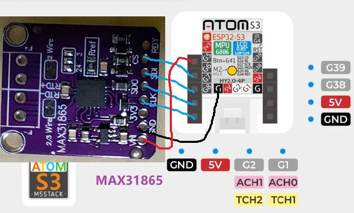

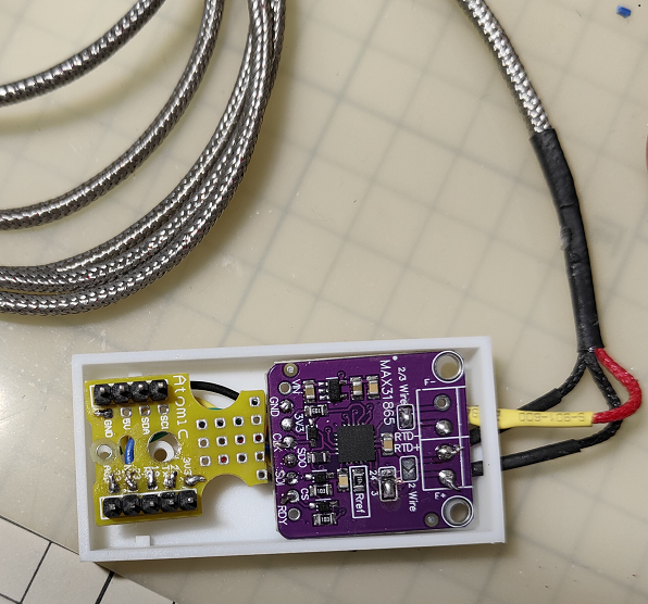

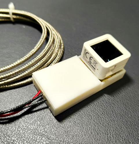

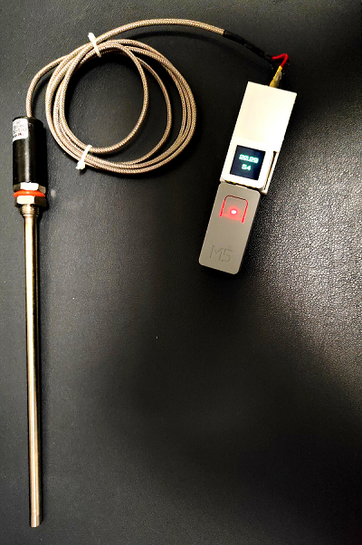

      (1) Part A: Front-end Data Acquisition and Transmission Terminal: A platinum RTD temperature sensor PT100 + MAX31865 + M5Stack AtomS3 form the acquisition, data processing, and transmission terminal capable of measuring the bean temperature in a semi-direct flame coffee roaster.
      Wiring:
      M5AtomS3 GPIO5 --> MAX31865 CS
      M5AtomS3 GPIO6 --> MAX31865 DI (MOSI)
      M5AtomS3 GPIO7 --> MAX31865 DO (MISO)
      M5AtomS3 GPIO8 --> MAX31865 CLK
      M5AtomS3 3V3 --> MAX31865 VIN
      M5AtomS3 GND --> MAX31865 GND

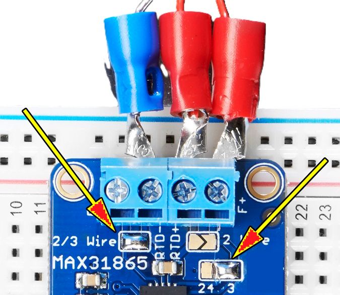

      PT100 Wiring:
      MAX31865 RTD- --> PT100 Blue wire
      MAX31865 RTD+ --> PT100 Red wire
      MAX31865 F+ --> PT100 Red wire (Note: This wiring suggests a 2-wire configuration. Typically F+ and F- are for fault detection and might be connected differently or not used. Standard 2-wire: RTD+ to one PT100 lead, RTD- to the other, often with F+ shorted to RTD+ and F- shorted to RTD- for 2-wire mode. Please verify based on MAX31865 datasheet and your specific PT100 sensor).
      Resistor Handling: 2/3 wire jumper shorted (for 2-wire mode).
      24-X connection open, X-3 shorted (likely refers to specific terminal block connections on some MAX31865 modules).

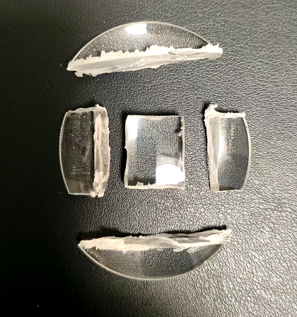

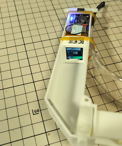

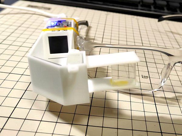

      (2) Roasting Glasses Part: M5Stack AtomS3 + lithium battery and its charging management module + the optical components of the glasses (mirror, magnifying lens, and beam splitter prism) + 3D printed glasses structure form the reception and display terminal.
      Step 1: Structure: 3D modeling and printing. Create a compartment for "AtomS3 + lithium battery and charging management module + micro switch". Create the optical path: from AtomS3 screen --> mirror --> magnifying lens --> beam splitter prism. The magnifying lens needs to be cut, leaving the central part. The beam splitter prism is 50:50.
      Step 2: Electrical: AtomS3 + lithium battery and charging management module + micro switch constitute the power management.
