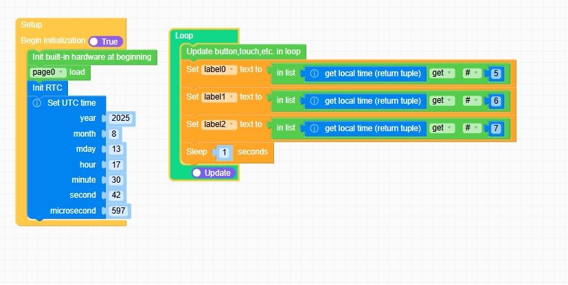

      I am using a Core S3 with UI Flow2 and having trouble with the RTC functions
      While the year month and day information of the tuple are correct, the hour and minute are not
      Hour is displayed as 0 instead of 17 and minutes are 17 instead of 31.
      Seconds are correct.
      I get the same results with a Core 2 under UI Flow2

        @csierra67 I reported this just a few days ago and the bug has been passed on the the team. See my post here https://community.m5stack.com/topic/7744/rtc-serious-bug-easy-fix-for-development-team
        The block is calling rtc.init(...), it should be calling rtc.datetime(...)

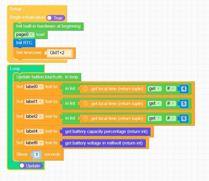

            @csierra67 Further to this suggestion, I tried the mpy route but got an error, type mismatch and the device frozen during upload needed to be burned again to recover control
            Finally I tried to not set the time and work with the Time section rather than the RTC section with the assumption that the device being connected to Internet anyway, it would get the correct time by itself.
            The following example works flawlessly and closes my issue as a reference for fuuture developperssolution.jpg
