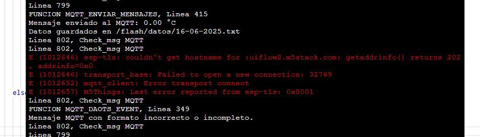

      Hi everyone, I'm having a problem with an M5tough that I use with a thermocouple and MQTT. I'm getting the following error. I don't know what it's due to or how to fix it. Has anyone else had the same problem? I searched the forum and couldn't find anything. Thanks for the help.

        @Jose-Manuel The error you're encountering (getaddrinfo() returns 202) typically indicates a DNS resolution issue, meaning the M5Tough is unable to resolve the hostname uiflow2.m5stack.com. Here are some steps to troubleshoot and resolve the issue:
