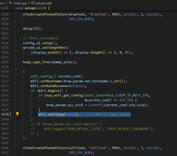

Last attempt: I have just added
WiFi.setSleep(false);in the setup() of main.cpp (M5StickC-Plus-TLite-FW.git). Let's see if it stays online (awake)

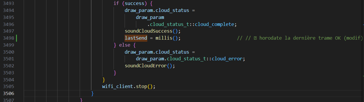

Since I still have interruptions in the json push, it might not be because the Wifi goes to sleep, but because for some reason (busy socket, frames collision, queue overflows, memory leak / heap fragmentation,...), the json is no longer posted... I added a soft reset of the ESP in the main loop whenever a delay from the last successfull of the POST is exceeded...
The soft reset seems to do the job (12 hours of measurements uninterrupted)
