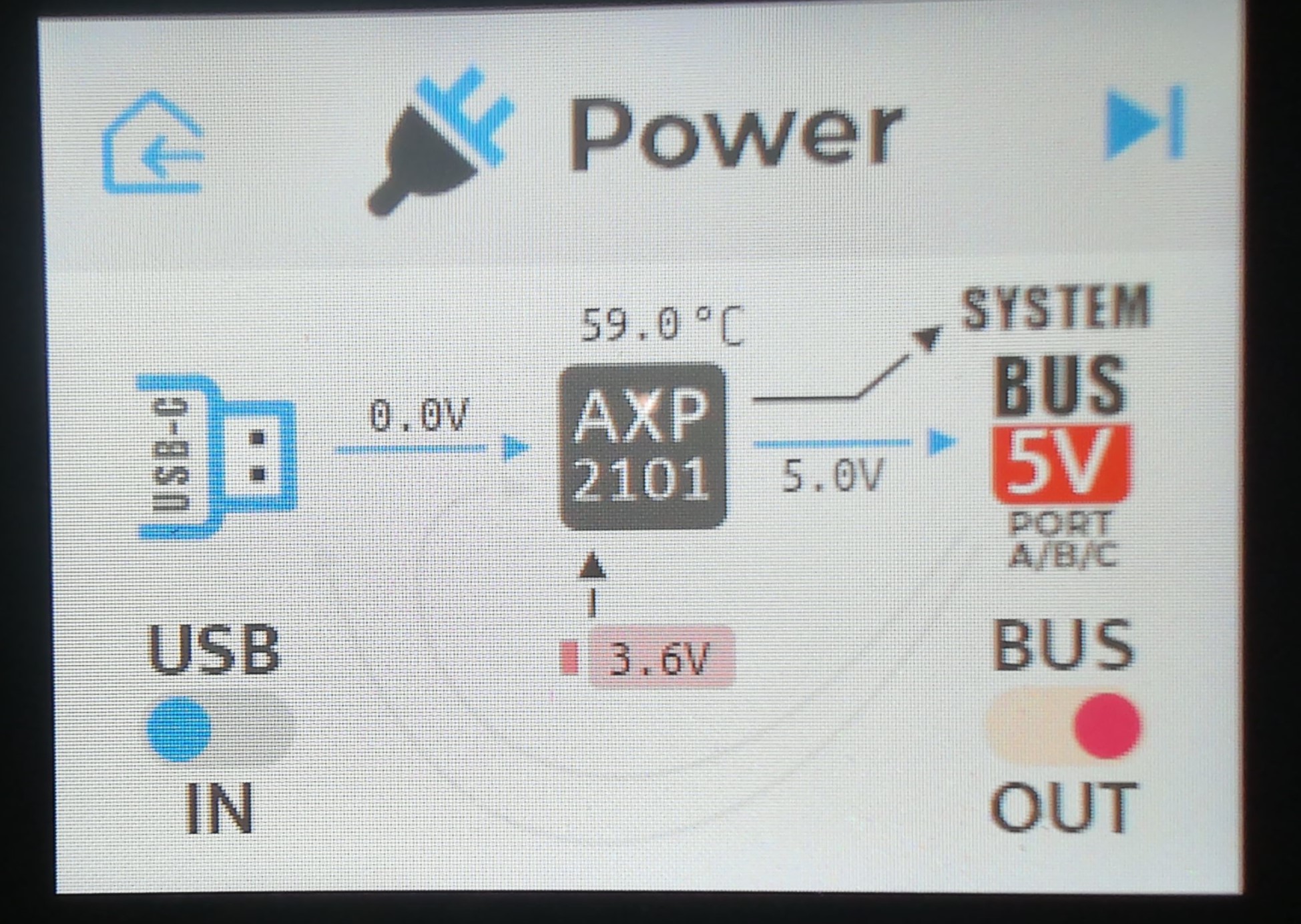

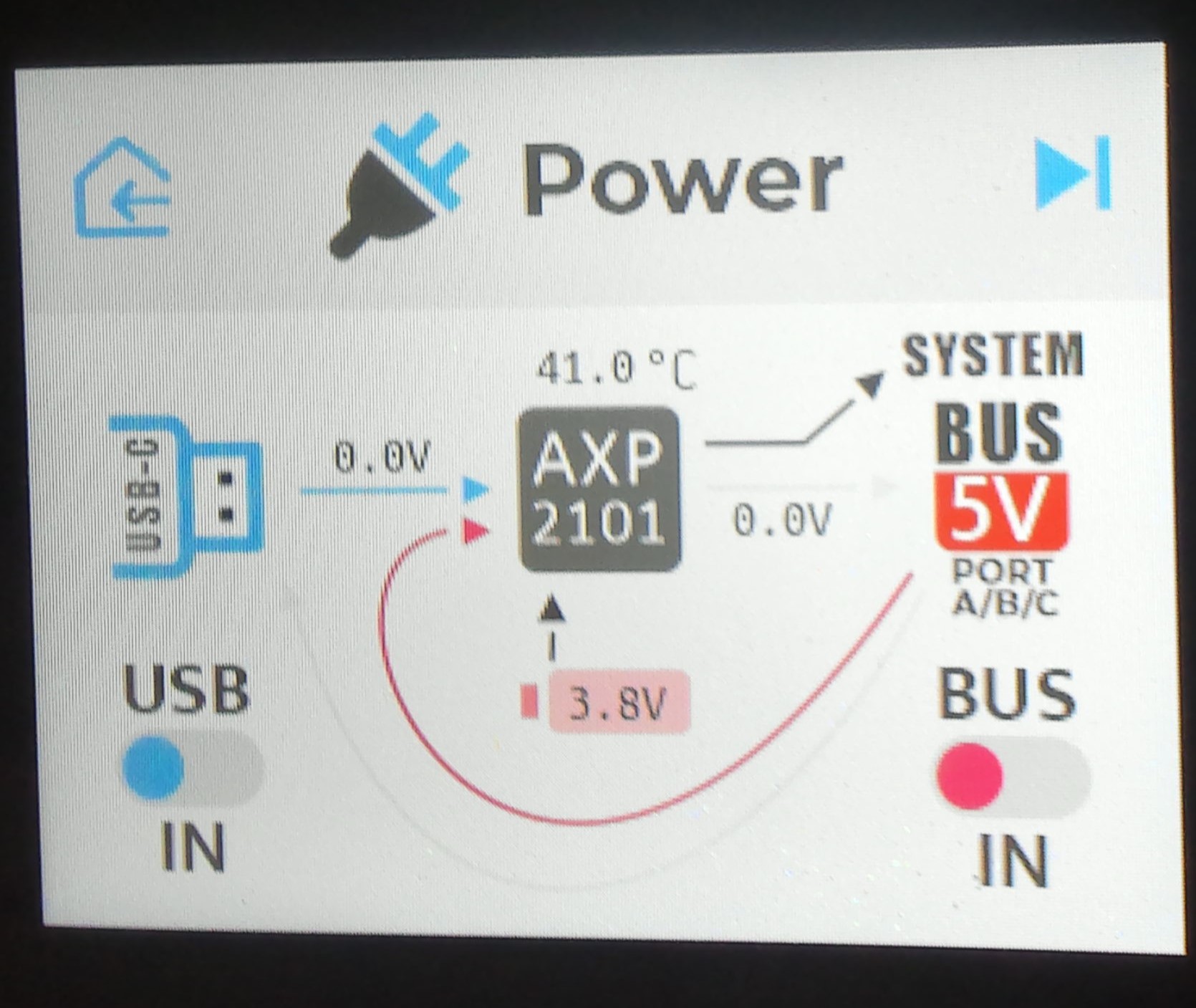

      My M5 CoreS3 develops an issue that the battery drains within half an hour from full and it heats up a lot. I has been programming with it together with a gps module and then a gps unit with no issue for about two weeks. I revert to demo program and disconnect all peripherals and the issue persists. I use the power options in the demo program and find that with bus out on the unit heat up to 60 degree and with bus out off the unit cool down to 40 degree. Any suggestion how I can troubleshoot this further?

        Please see the demo program images to better illustrate what I observe. This is just the core s3 with demo program without anything else attached/connected.1_1710233257219_WIN_20240312_16_42_12_Pro.jpg 0_1710233257219_WIN_20240312_16_33_46_Pro.jpg

          from a fully charged battery my M5CoreS3 was running about 3.5 hours until shutdown. Bus out was on, nothing connected to it and the temperature was about 30 degrees.
          I noticed that your bus voltage reading is 5.0 V (mine shows 5.1 V). It is almost like there is some load?
          I can force mine to go down to 5.0 V by adding an external load of about 15 Ohm. Then I see the temperature rising, but still only to about 42 degrees.
          Given that your M5CoreS3 heats up to 59 degrees suggests there is an even greater load / internal short.
          Given the battery is 500 mA/h and yours is drained after half an hour would suggest a current of about 1 A out of the battery.

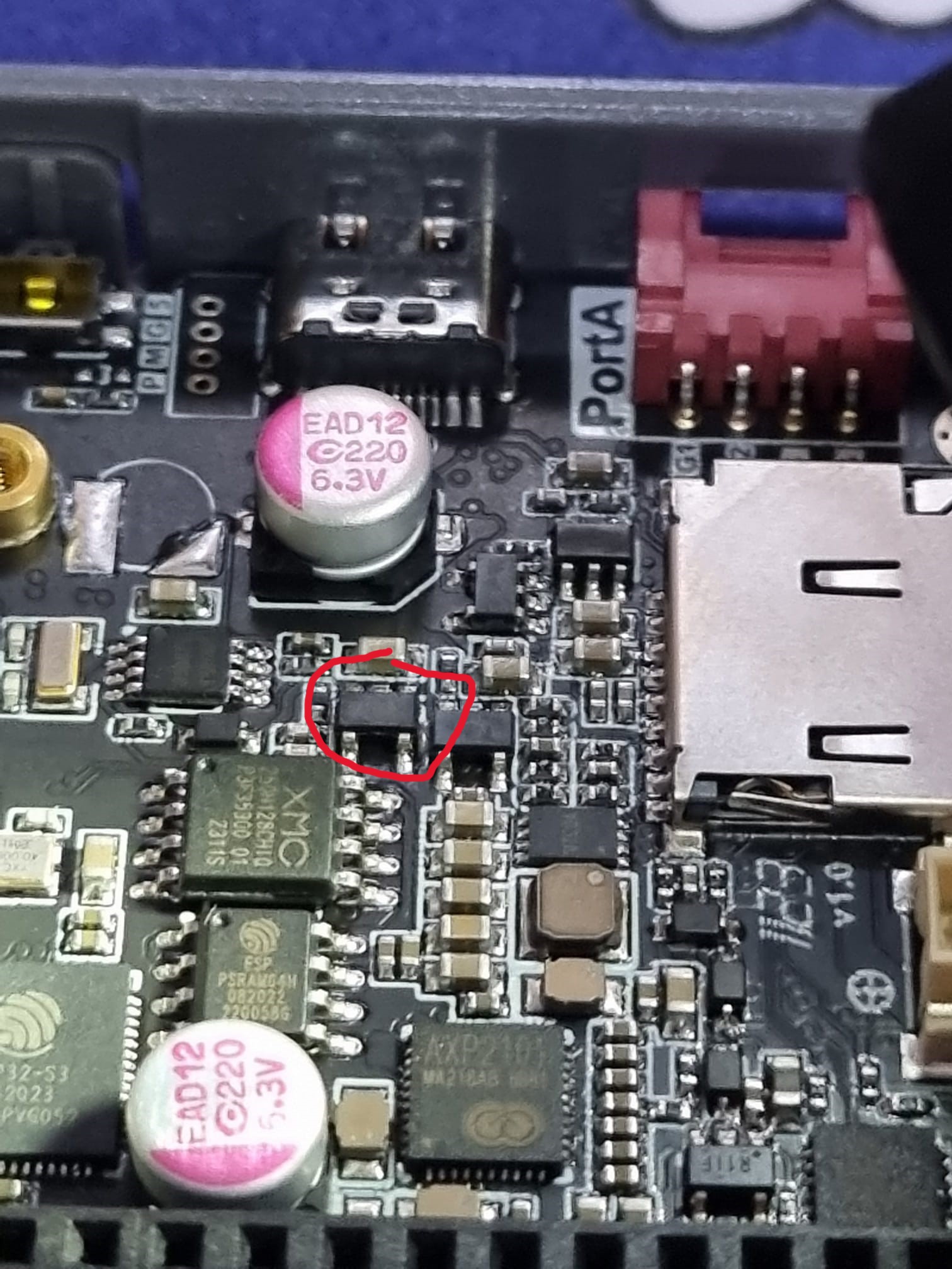

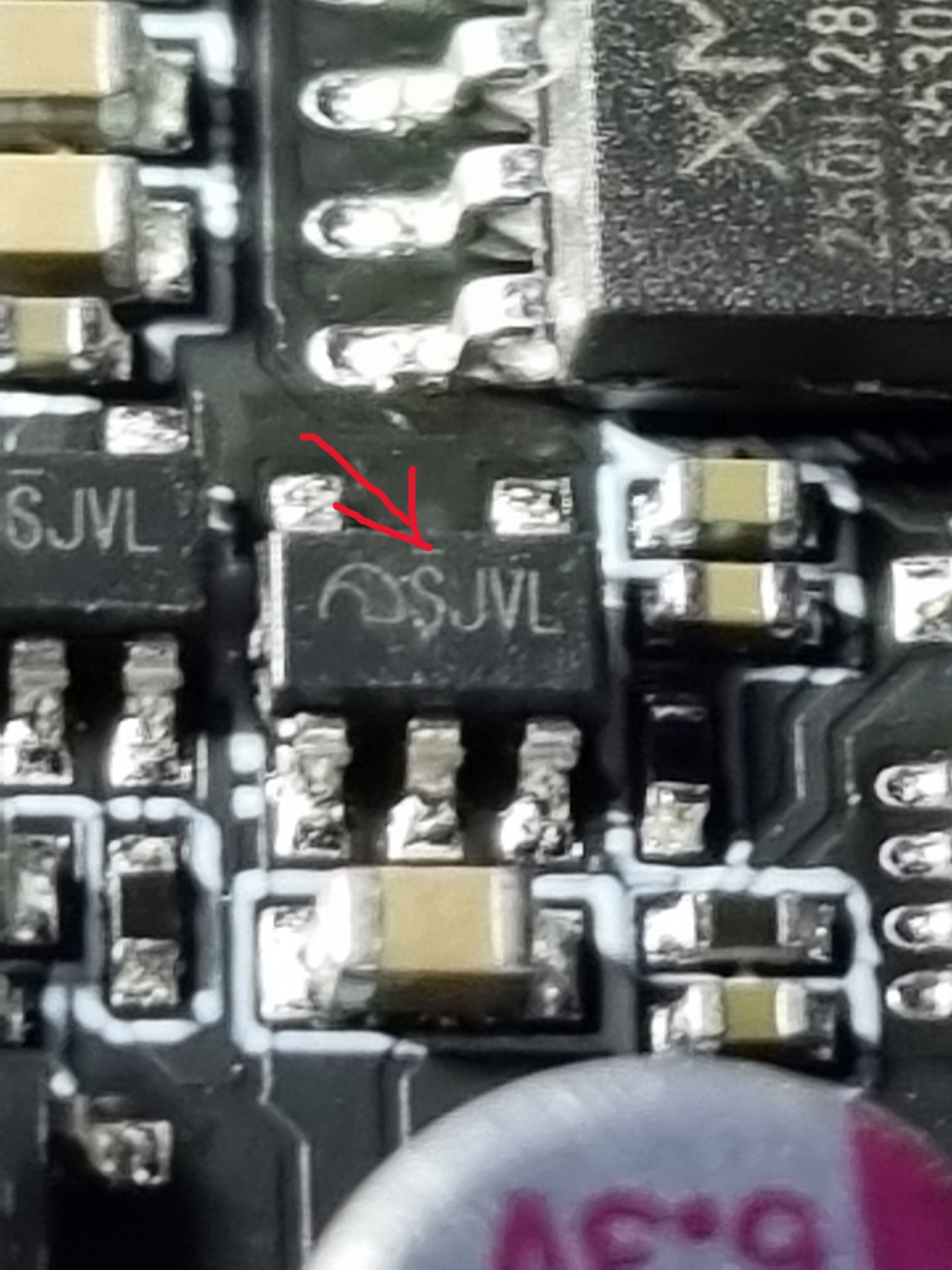

            I have opened up my unit further and, with some thermal probing, found that the highlighted chip gets to 70 degree and seems to be where the short is. I know that my unit is pretty much dead with this short. I just wonder if anyone know what this SJVL chip is as google failed to gives me any hint.

              if I am not totally mistaken this is U17 - it's used to power USB (OUT) when running from battery (and BUS is set to OUT).
              Please see my drawing here and schematic here.
              Thanks
              Felix
