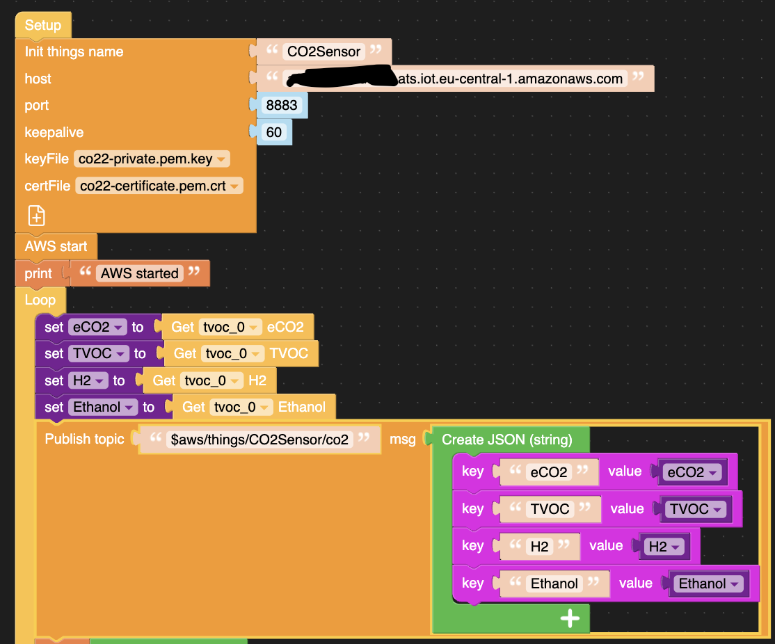

      Hi all,
      I struggle to get my m5stack Atom Matrix to connect to AWS. I double checked the AWS setup including the policy etc. There seem to be a problem with the connection I always get the following error when trying to publish something:
      [45944] MQTTException -> [Errno 9] EBADF
      reconnect start ...
      reconnect finish ...
      [48536] MQTTException -> [Errno 9] EBADF
      reconnect start ...
      It also seems there changed some things recently. All examples I find are with a block called "dump to json" but this is no longer available. I work with "create JSON (string) and keys. See the picture.
      Code is here:
      from m5stack import *
      from m5ui import *
      from uiflow import *
      from IoTcloud.AWS import AWS
      from libs.json_py import *
      import time
      import unit
      rgb.set_screen([0,0,0,0,0,0,0,0,0,0,0,0,0,0,0,0,0,0,0,0,0,0,0,0,0])
      tvoc_0 = unit.get(unit.TVOC, unit.PORTA)
      eCO2 = None
      TVOC = None
      H2 = None
      Ethanol = None
      aws = AWS(things_name='CO2Sensor', host='xxxxxxxxxxx-ats.iot.eu-central-1.amazonaws.com', port=8883, keepalive=60, cert_file_path="/flash/res/co22-certificate.pem.crt", private_key_path="/flash/res/co22-private.pem.key")
      aws.start()
      print('AWS started')
      while True:
      eCO2 = tvoc_0.eCO2
      TVOC = tvoc_0.TVOC
      H2 = tvoc_0.H2
      Ethanol = tvoc_0.Ethanol
      aws.publish(str('$aws/things/CO2Sensor/co2'),str((py_2_json({'eCO2':eCO2,'TVOC':TVOC,'H2':H2,'Ethanol':Ethanol}))))

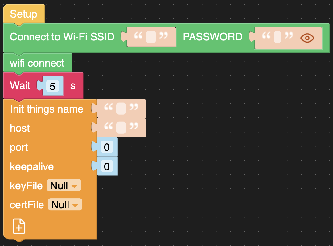

                Your setup need to look like this:

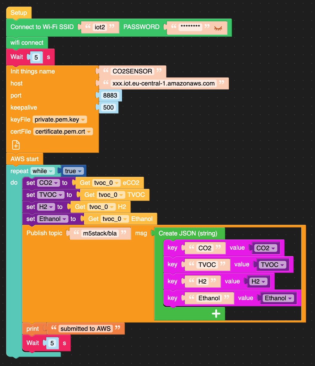

                  Still have the problem. I rebuilt the whole program to make sure there are no "old" blocks in there. Don't even see a connection attempt on AWS (IoT Core with enabled debug logging)
                  ATOM Matrix
                  Firmware: 1.13.2
                  Both in Internet and App mode
                  -- Code --
                  from m5ui import *
                  import wifiCfg
                  import time
                  import unit
                  CO2 = None
                  TVOC = None
                  H2 = None
                  Ethanol = None
                  wifiCfg.doConnect('Guest', 'xxx')
                  wifiCfg.autoConnect(lcdShow=False)
                  wait(5)
                  aws = AWS(things_name='CO2SENSOR', host='xxx.iot.eu-central-1.amazonaws.com', port=8883, keepalive=500, cert_file_path="/flash/res/certificate.pem.crt", private_key_path="/flash/res/private.pem.key")
                  aws.start()
                  while True:
                  CO2 = tvoc_0.eCO2
                  TVOC = tvoc_0.TVOC
                  H2 = tvoc_0.H2
                  aws.publish(str('m5stack/bla'),str((py_2_json({'CO2':CO2,'TVOC':TVOC,'H2':H2,'Ethanol':Ethanol}))))
                  print('submitted to AWS')
                  wait(5)

                  • C
                    chr1g1
                    Okay - testet the very same code with an MStickC. Runs very smooth without issues. Either there are bugs in the code of the Atom Matrix or the device has just too less resources to handle an external sensor along with an IoT connection.
