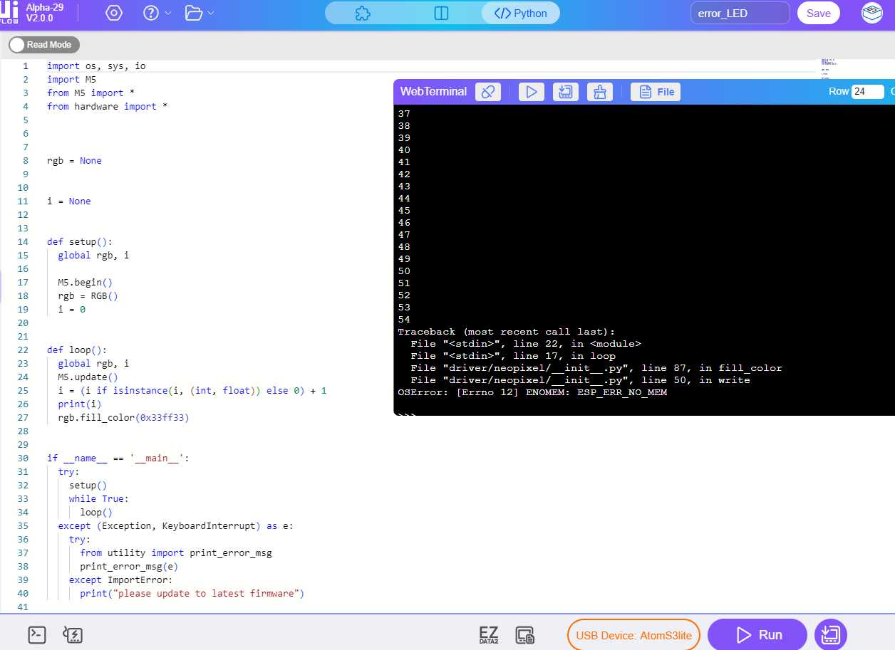

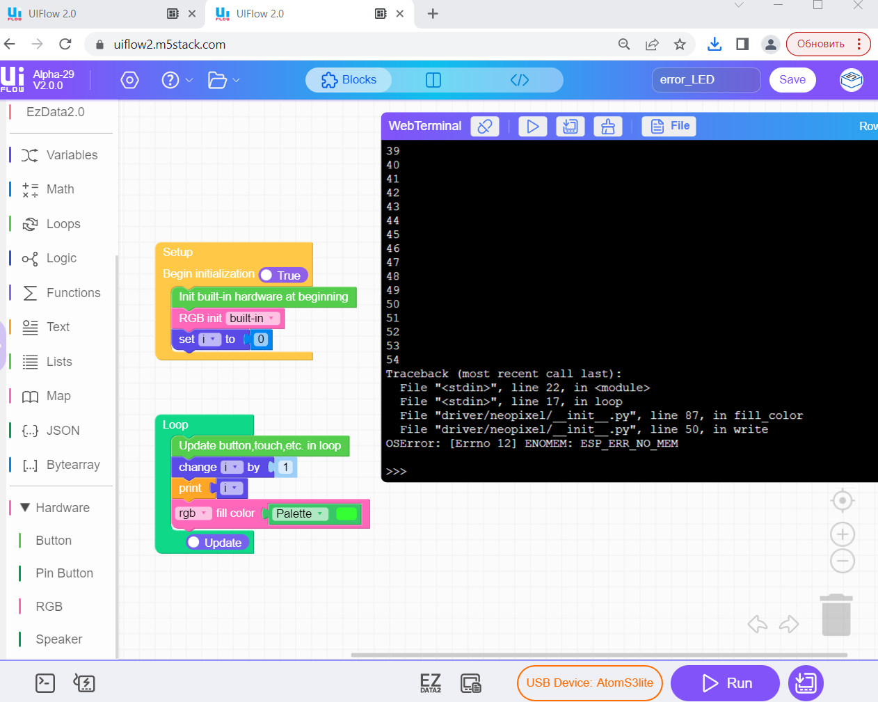

    ***Bug*** ERROR use RGB - Freezes after loop execution: 54 times [Alpha-29, AtomS3-lite]
    3 Posts 3 Posters 2.2k Views
    • S Offline
      Slater
      def loop():
      global rgb, i
      M5.update()
      i = (i if isinstance(i, (int, float)) else 0) + 1
      print(i)
      rgb.fill_color(0x33ff33)
      _________ error ________
      52
      53
      54
      File "<stdin>", line 24, in <module>
      File "<stdin>", line 19, in loop
      File "driver/neopixel/init.py", line 87, in fill_color
      File "driver/neopixel/init.py", line 50, in write
      OSError: [Errno 1] EPERM: ESP_FAIL
      • felmueF Offline
        felmue
        Hello @Slater
        try adding a Sleep 100 microseconds block after rgb fill color block to slow down the loop. Works for me.
        Thanks
        Felix
        Examples
        • lbuqueL Offline
          lbuque
          @Slater This bug is not reproduced in uiflow 2.0.1
