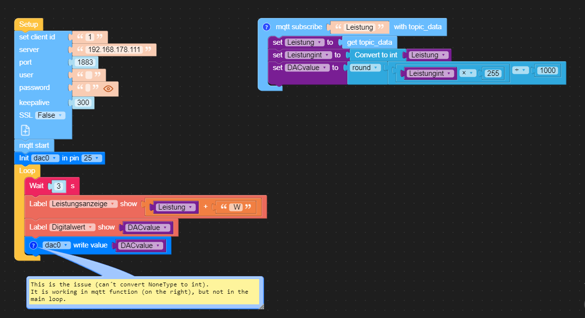

      Hello,
      I am working on a simple program.
      I receive a value between 0 and 1000 by MQTT and convert it to a digital value from 0 to 255.
      Then I want to put it on the DAC channel 0.
      But if I want to proceed with the digital value within the main loop I get the error "Can´t convert NoneType to int".
      I understand that this is a NoneType, which can´t convert into an integer, but I need to work with the digital value in the main loop, because I have to do some calculations (filtering), which is not possible in the MQTT function.
      How can I solve this issue?

        I found a workaround meanwhile with if-else.
        It is not nice, but it´s working:
        • I convert the DAC Value into a String.
        • Then I check, if it is "None", if yes I send a 0 to the DAC.
        • If DAC Value is not "None" I convert it back to integer and send it directly to the DAC.
        • ajb2k3A
          ajb2k3
          Are you using a “convert to int” block to convert the value being sent to the dac?
