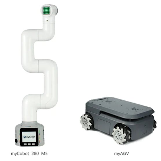

      The equipment that I am using includes:

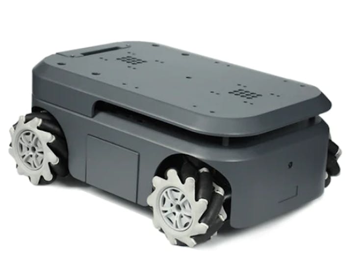

      myAGV, a SLAM car that is capable of mapping and navigation.
      alt text
      myCobot280 M5Stack, a six-axis collaborative robotic arm with a complete API interface that can be controlled via Python.alt text

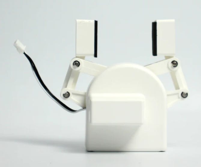

      An adaptive gripper that can be mounted as an end effector with MyCobot280, which is capable of grasping objects.alt textalt text

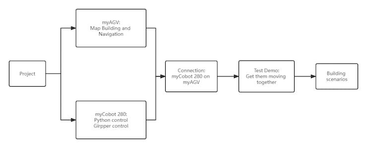

      The picture below shows the general flow of this project.alt text
      I split the function into one, a small part to be implemented independently and finally integrated together.

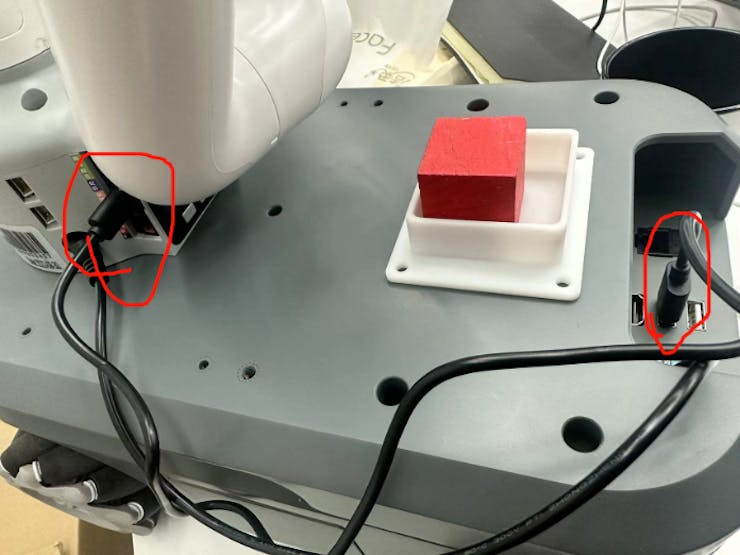

      After dealing with the small functions, the next step is to establish communication between myCobot and myAGV.
      • The controller of myAGV is a Raspberry Pi, which is a micro-computer (with Ubuntu 18.04 system) that can be programmed on it.
      • MyCobot 280 M5Stack needs to be controlled by commands sent from a computer.
      Based on the above conditions, there are two ways to establish communication between them:
      • Serial communication: directly connect them using a TypeC-USB data cable (the simplest and most direct method).
      • Wireless connection: myCobot supports WIFI control, and commands can be sent by entering the corresponding IP address (more complicated and communication is not stable).
        Here, I choose to use serial communication and directly connect them with a data cable.
        alt text
