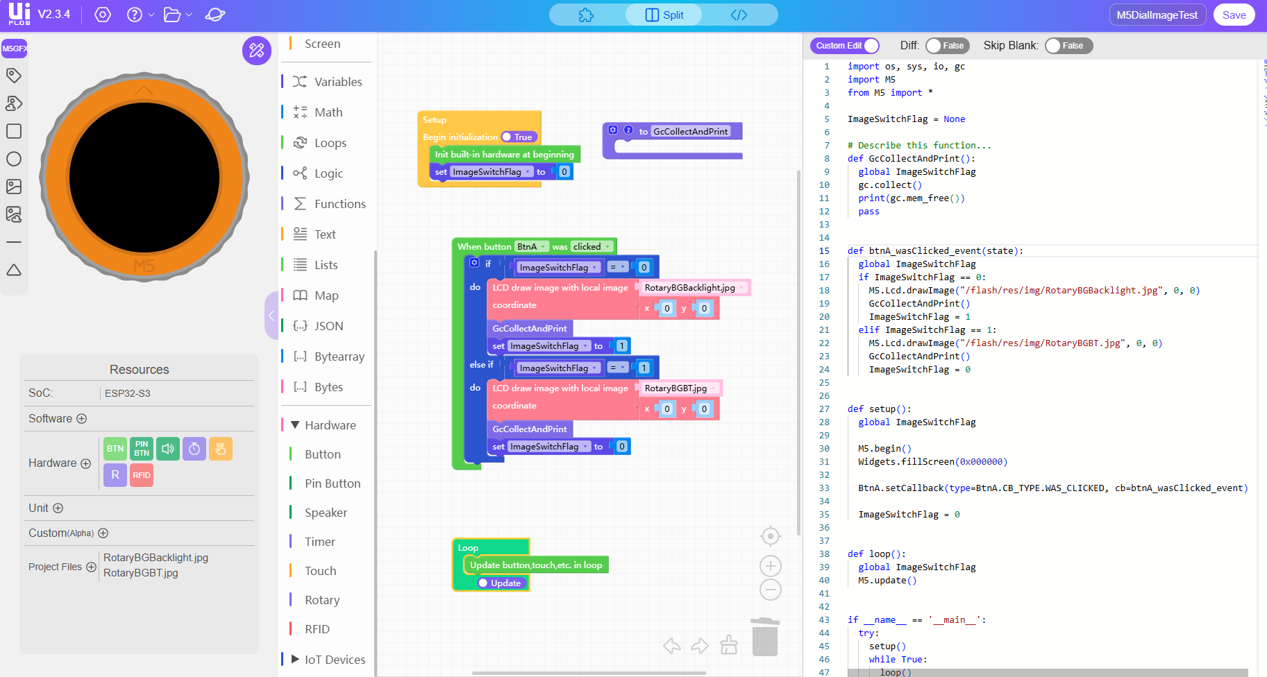

                  zhumingqi
                  Today, I updated the UIFlow to V2.3.4, and burned V2.3.4 firmware as well. Then I tested that image component again with M5GFX in UIFlow 2.3.4. But the issue still exists. After I switch two JPG pics with one image component for sometime, the memory will reduced continiously. Finally, the system will break out. And I try to use gc.collect() after every drawImage(), but it's not useful.
                  Here is my design and python code:
                  import os, sys, io, gc
                  import M5
                  from M5 import *
                  ImageSwitchFlag = None
                  def GcCollectAndPrint():
                  global ImageSwitchFlag
                  gc.collect()
                  print(gc.mem_free())
                  pass
                  def btnA_wasClicked_event(state):
                  if ImageSwitchFlag == 0:
                  M5.Lcd.drawImage("/flash/res/img/RotaryBGBacklight.jpg", 0, 0)
                  GcCollectAndPrint()
                  ImageSwitchFlag = 1
                  elif ImageSwitchFlag == 1:
                  M5.Lcd.drawImage("/flash/res/img/RotaryBGBT.jpg", 0, 0)
                  GcCollectAndPrint()
                  ImageSwitchFlag = 0
                  def setup():
                  M5.begin()
                  Widgets.fillScreen(0x000000)
                  BtnA.setCallback(type=BtnA.CB_TYPE.WAS_CLICKED, cb=btnA_wasClicked_event)
                  ImageSwitchFlag = 0
                  def loop():
                  M5.update()
                  if name == 'main':
                  try:
                  setup()
                  while True:
                  loop()
                  except (Exception, KeyboardInterrupt) as e:
                  try:
                  from utility import print_error_msg
                  print_error_msg(e)
                  except ImportError:
                  print("please update to latest firmware")******

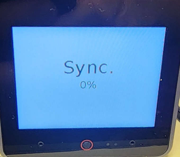

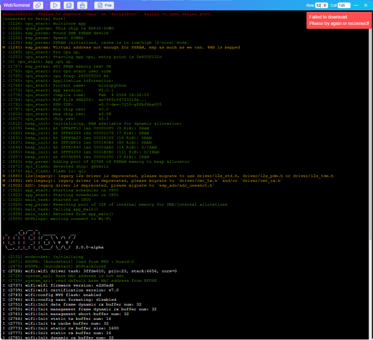

                  • S Offline
                    Schwibach

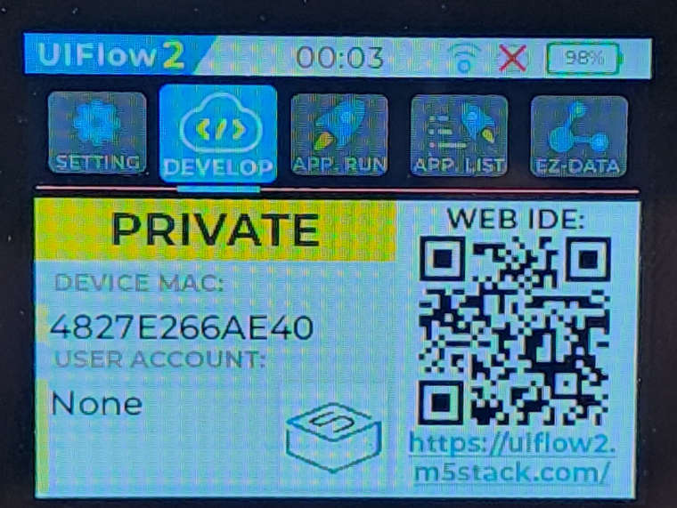

                    I wrote in another thread about my Sync... 0% problem.
                    I am pretty sure now that it is a bug. I does not matter which program I use. I can run them from UIFlow 2.0. But as soon as I download a program, I will get the Sync... 0%
                    Also, if I burn firmware without selecting startup, it will not even connect to UIFlow 2.0.
                    I would really appreciate any guidance you could give.

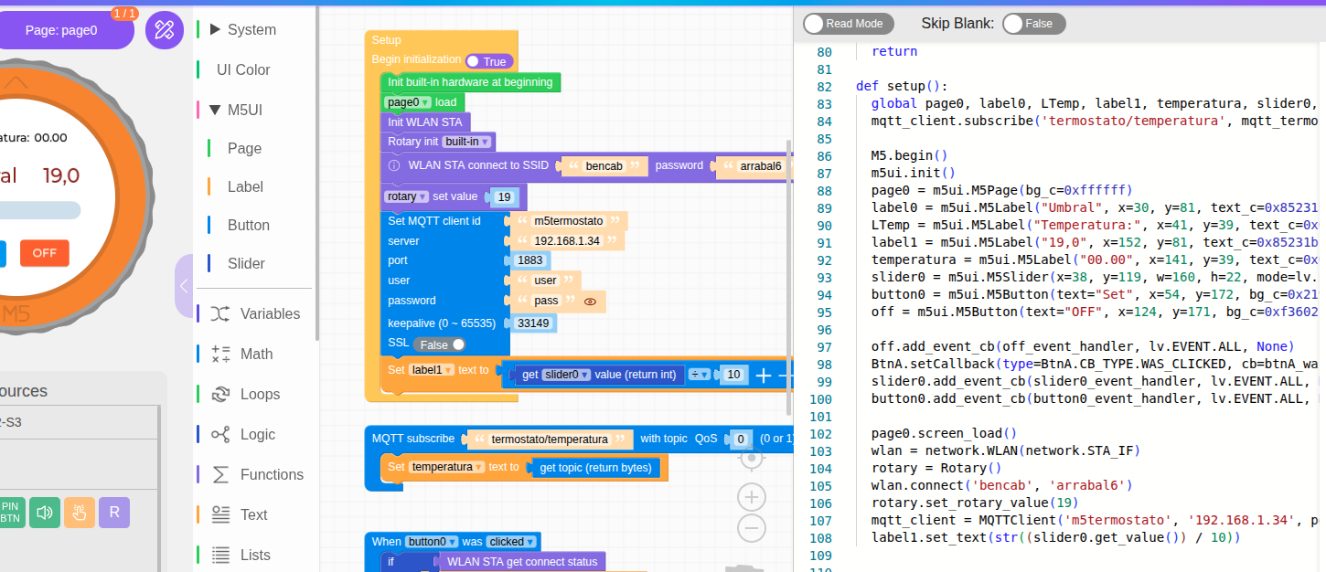

                    • O Offline
                      otosan-maker
                      I have found a bug in MQTT software. When I subscrive to a topic, the python code creates the subscription at the beggining of the setup code, before it connects to wifi and mqtt.
                      Here is the sample:
                      def setup():
                      global page0, label0, LTemp, label1, temperatura, slider0, button0, off, mqtt_client, wlan, rotary
                      mqtt_client.subscribe('termostato/temperatura', mqtt_termostato_temperatura_event, qos=0)
                      M5.begin()
                      m5ui.init()
                      page0 = m5ui.M5Page(bg_c=0xffffff)
                      label0 = m5ui.M5Label("Umbral", x=30, y=81, text_c=0x85231b, bg_c=0x302c2c, bg_opa=0, font=lv.font_montserrat_24, parent=page0)
                      LTemp = m5ui.M5Label("Temperatura:", x=41, y=39, text_c=0x000000, bg_c=0xffffff, bg_opa=0, font=lv.font_montserrat_14, parent=page0)
                      label1 = m5ui.M5Label("19,0", x=152, y=81, text_c=0x85231b, bg_c=0xffffff, bg_opa=0, font=lv.font_montserrat_24, parent=page0)
                      temperatura = m5ui.M5Label("00.00", x=141, y=39, text_c=0x000000, bg_c=0xffffff, bg_opa=0, font=lv.font_montserrat_14, parent=page0)
                      slider0 = m5ui.M5Slider(x=38, y=119, w=160, h=22, mode=lv.slider.MODE.NORMAL, min_value=190, max_value=290, value=210, bg_c=0x115e9f, color=0x2c90e4, parent=page0)
                      button0 = m5ui.M5Button(text="Set", x=54, y=172, bg_c=0x2196f3, text_c=0xffffff, font=lv.font_montserrat_14, parent=page0)
                      off = m5ui.M5Button(text="OFF", x=124, y=171, bg_c=0xf36021, text_c=0xffffff, font=lv.font_montserrat_14, parent=page0)
                      off.add_event_cb(off_event_handler, lv.EVENT.ALL, None)
                      slider0.add_event_cb(slider0_event_handler, lv.EVENT.ALL, None)
                      button0.add_event_cb(button0_event_handler, lv.EVENT.ALL, None)
                      page0.screen_load()
                      wlan = network.WLAN(network.STA_IF)
                      rotary = Rotary()
                      wlan.connect('bencab', 'arrabal6')
                      rotary.set_rotary_value(19)
                      mqtt_client = MQTTClient('m5termostato', '192.168.1.34', port=1883, user='user', password='pass', keepalive=33149)
                      label1.set_text(str((slider0.get_value()) / 10))

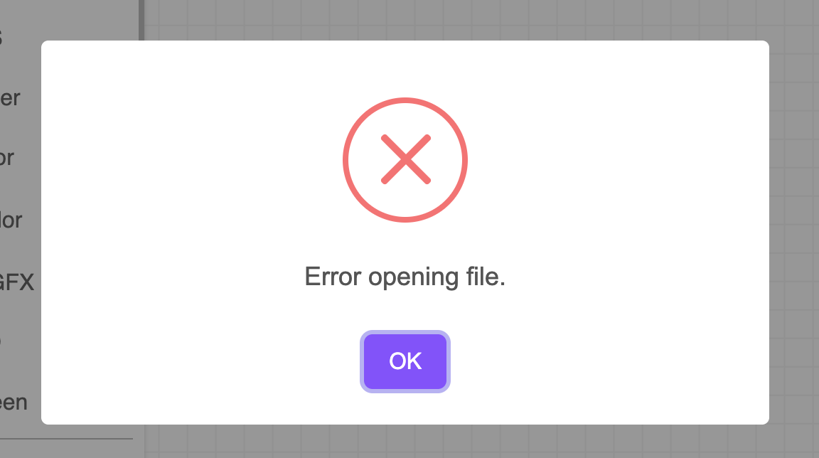

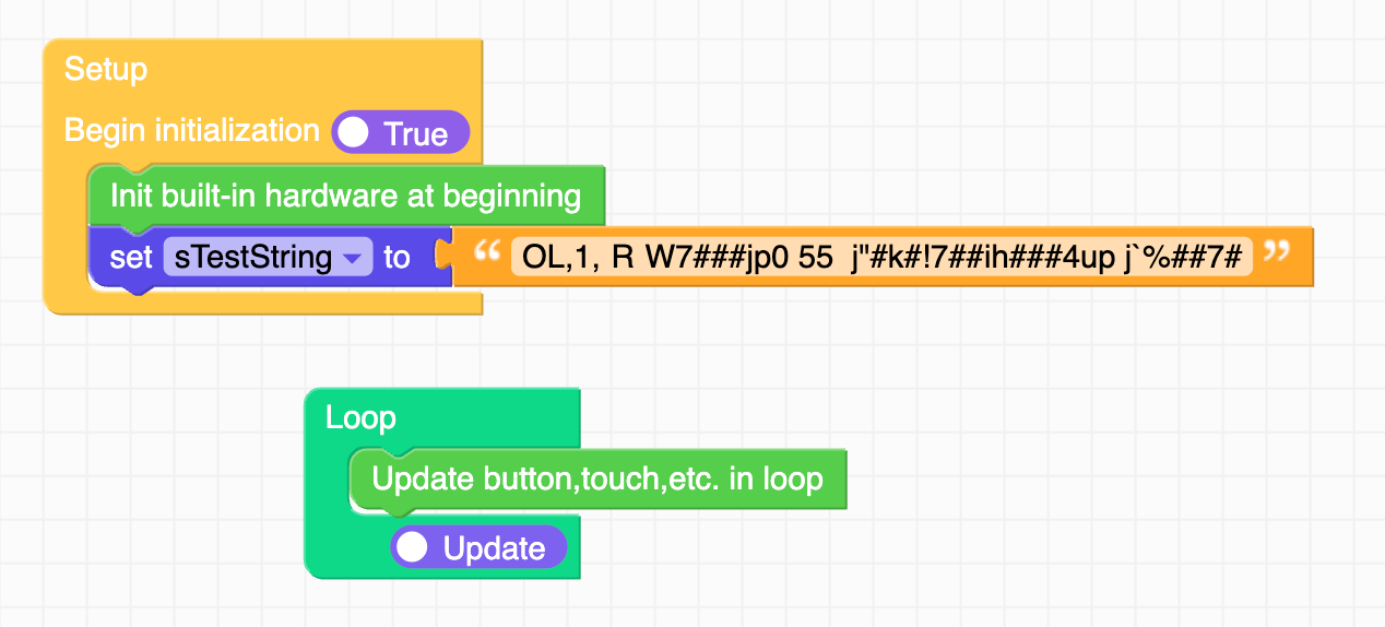

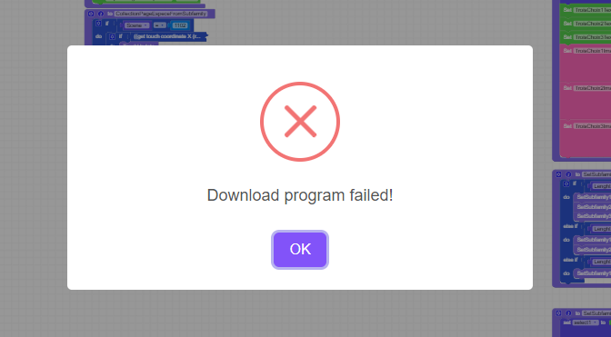

                          • G Offline
                            GuerillaPlanter
                            Thank you for the M5Stack devices and coding tools. This community forum has been a great help too. I have been successfully using UiFlow2 to create code for a Cardputer. But I think there is a bug in the UiFlow2 web UI and/or m5f2 file format.
                            THIS WORKS: I can save to the cloud, save the project to a local file, and reimport that file, when the script is like:
                            sTestString = None
                            def setup():
                              global sTestString
                              M5.begin()
                              sTestString = 'hello'
                            def loop():
                              global sTestString
                              M5.update()
                            THIS DOESN'T WORK: If I edit it and assign a particular more complex value to the string, I cannot save to the cloud, nor reimport a file saved locally:
                            sTestString = 'OL,1,RW7###jp0 55  j"#k#!7##ih###4up j`%##7#'
                            This string happens to be a line from a teletext page .tti file, which includes some display control codes. Here is a screenshot of the code which can't be saved to the cloud or reimported, in the UiFlow2 UI:
                            Decoding this string's value is:
                            \u004f\u004c\u002c\u0031\u002c\u001b\u0052\u007f\u001b\u0057\u0037\u0023\u0023\u0023\u006a\u0070\u0030\u0020\u0035\u0035\u0020\u0020\u006a\u0022\u0023\u006b\u0023\u0021\u0037\u0023\u0023\u0069\u0068\u0023\u0023\u0023\u0034\u0075\u0070\u0020\u006a\u0060\u0025\u0023\u0023\u0037\u0023
                            While the script cannot be saved to the cloud (there is no response), the project can be saved to a local file. In the .m5f2 project file, the relevant saved value is:
                            <field name=\"VAR\" id=\"usN/c#7FD;q`ieH|V~5K\">sTestString</field><value name=\"VALUE\"><block type=\"text\" id=\"ap8ErHQgaUZ`^d-W-%_I\"><field name=\"TEXT\">OL,1,\u001bR\u001bW7###jp0 55  j\"#k#!7##ih###4up j`%##7#</field></block></value>
                            This local file cannot then by imported again into UiFlow2, giving an "error opening file" message:
                            I believe the problem is related to some unicode characters rather than the " character.
