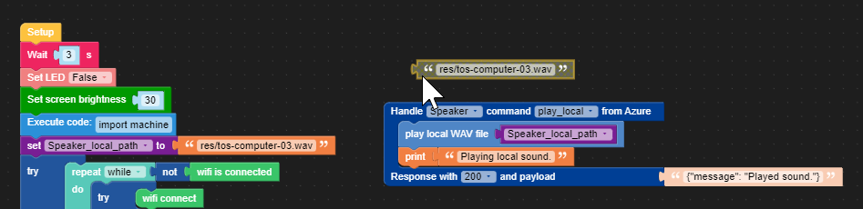

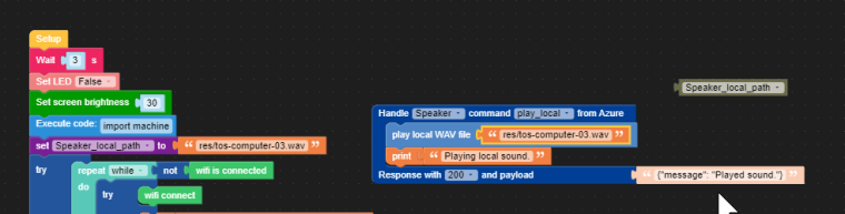

      This does not work:
      But this does:
      For some reason you have to hard-code the string of the local file path, this handler won't accept the variable and produces an error:
      OSError [Errno 2] ENOENT
