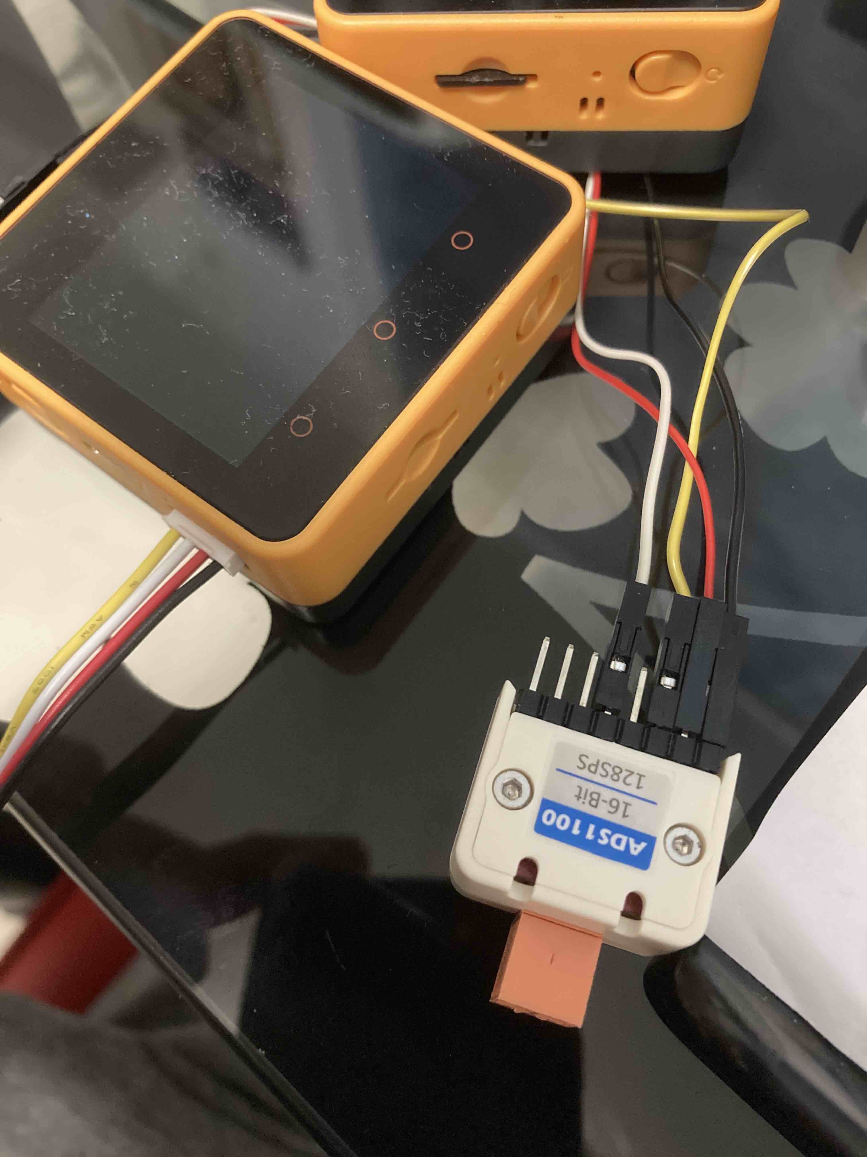

      Dear all,
      I need a better resolution for a project and I have seen that the internal ADC of the ESP32 is really noisy. So I ordered an ADS1100 for my Core2.
      In the meantime I tried to connect an ADS1100 hat (that I bought for an M5Stick).
      I connected it to the Port A of my Core2

      When I upload I read:
      ADC unit maybe not connect
      Any suggestion?

        Hello @brvus76
        according to the schematic the hat needs 3.3 V.
        Thanks
