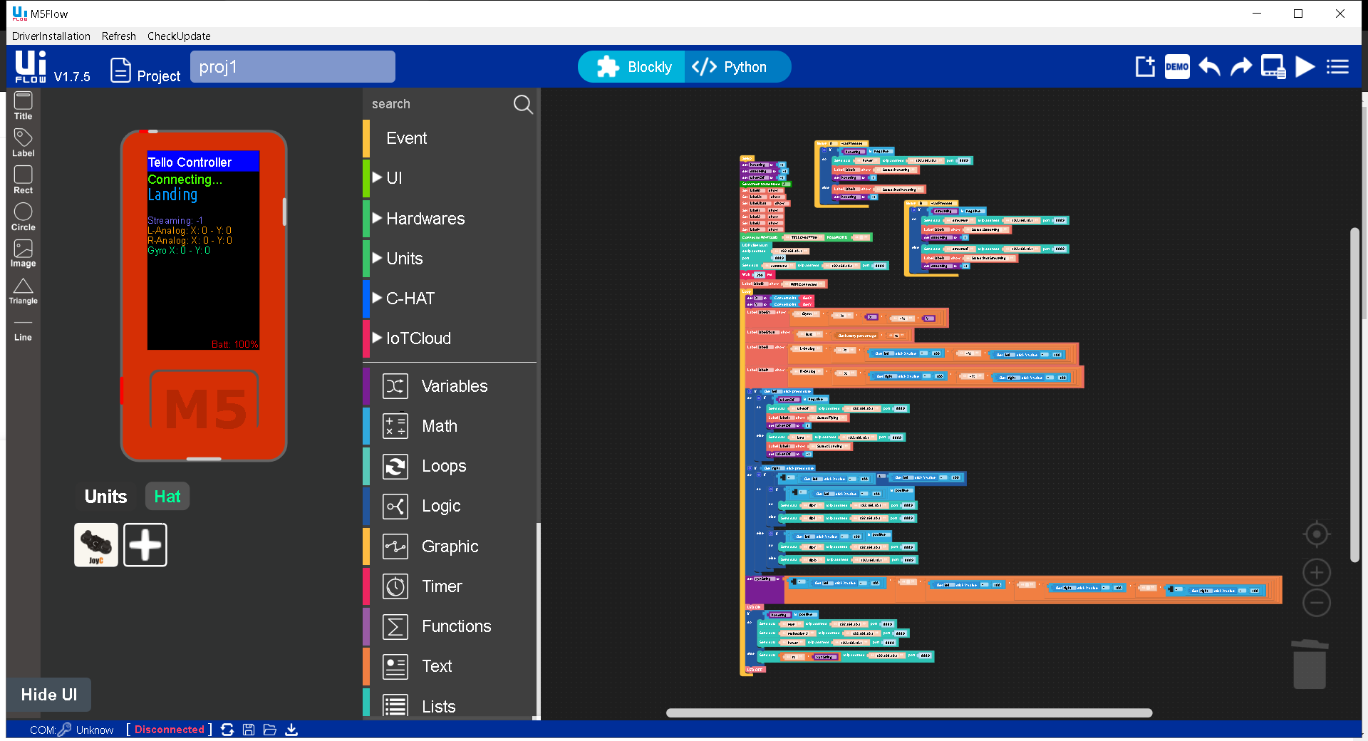

      UIFLOW Block File: https://file.io/dOIYsVphE7Bx
      This will allow you to control the tello with the joyc hat!
      Controls:
      right push while turning the device to the angle you want it to flip (fblr)
      left push land/takeoff
      A: HOVER ON/OFF
      B: STREAM VIDEO ON/OFF
