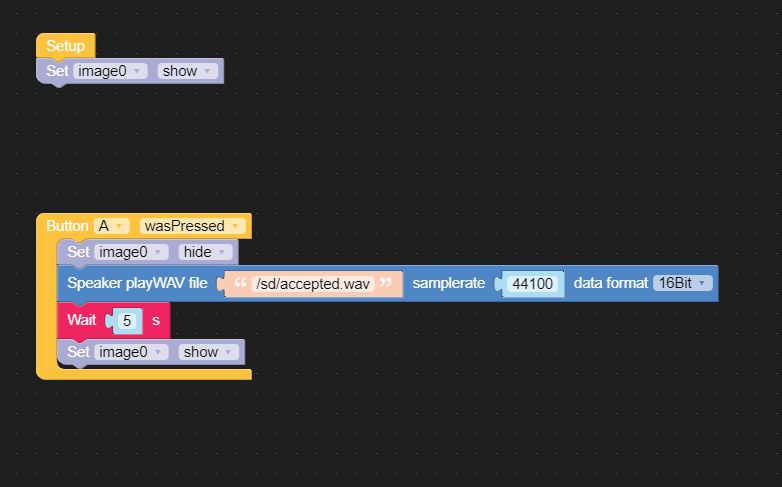

      What I'm trying to do :
      • Display image 0 ( PNG , in Flash , 330 x 240 36.4 KB )
      • Wait for Button A to be pressed
      • Hide Image 0
      • Play WAV file ( SD card )
      • Show Label0
      • Wait 5
      • Show Image 0
      What happens :
      Everything works, with the exception of the image show/hide/show. It constantly shows after button A is pressed. Wave file pays, but no change to the image.
      Coded in Blockly,
      Python :
      from m5stack import *
      from m5stack_ui import *
      from uiflow import *
      import time
      screen = M5Screen()
      screen.clean_screen()
      screen.set_screen_bg_color(0xFFFFFF)
      image0 = M5Img("res/Untitled-2.png", x=0, y=0, parent=None)
      def buttonA_wasPressed():
        # global params
        image0.set_hidden(True)
        speaker.playWAV('/sd/accepted.wav', rate=44100, dataf=speaker.F16B)
        wait(5)
        image0.set_hidden(False)
        pass
      btnA.wasPressed(buttonA_wasPressed)
